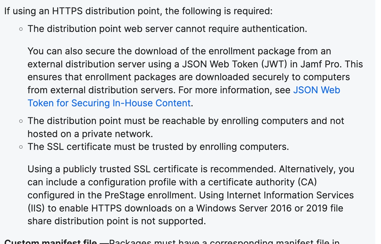

We are on-prem Jamf so the package is deployed via an HTTPs distribution point configured on a separate web server. I can see from the IIS logs that the MacBook Neo does access the pkg file on the web server

  • Jun 4, 2026 10:28 AM UTC
Priority for the package is “1” we only have one package.
Refer this

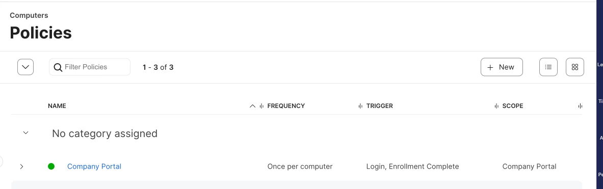

To add this, did you added policy for the company portal also

Hi,
The HTTPS distribution point is secured with an external certificate and doesn’t require any authentication.
I don’t have a Policy for Company Portal, what would this contain, I don’t think I’ve seen it mentioned in the documentation I’ve read.

Create a policy for installing Company portal package and select trigger action as enrolment complete. During prestage, company portal will get installed once enrolment is finished.

Adding won’t be enough. we need to create a separate policy scoping to devices.

  • Jun 4, 2026 1:39 PM UTC
Didn’t work unfortunately, the MacBook Neo moved on to the create user account page after a period of time skipping past PSSO.
The policy to install company portal completed after the above had occurred
On a restart PSSO is picked up during setup but after signing in via Entra I’m prompted for a username and password that won’t accept any credentials.
Jamf Logs say this over and over until it was restarted -
[WARN ] [Tomcat-26  ] [DeviceConfiguredHelper   ] - Device 64 failed verify await configuration complete check
