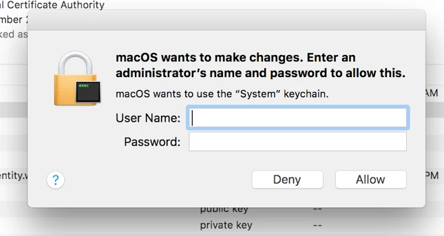

Testing out GlobalProtect for our Mac users and running into this keychain issue. We are using a local Certificate for authentication but the machine wants to use the system keychain every time GP tries to connect. The goal is to have the users never have to authenticate or enter a password after the local cert is installed.
I have already amended the ACL to include the GP app but the keychain still wants to be accessed. I am also using an administrator account, but still am prompted. If I manually unlock the System keychain from the keychain menu I am still prompted when I try and connect.
Thank you for any help or tips someone may have.

Working with Palo Alto, I finally got a support person with a good answer for this.
1. Open Keychain Access.app 2. Under the "System" keychain select Category: "Passwords" and search for "GlobalProtectService" 3. Delete the GlobalProtectService application-password from the system keychain 4. Reboot MacOS 5. Test if GlobalProtect version 5.2.3 still gives you the same issue
I took these steps, and no more prompt to change the system keychain, and the GlobalProtectService application-password is automatically recreated.
In at least my case, this has to do with the change in bundleIdentifier that happened between 5.0 and 5.1.2+ where the GlobalProtectService item is a password for the old identifier and there is a collision. Deleting the old file allows the new app to update the keychain, I suppose with the proper permissions.
For those of us who don't want to take all the manual steps at all the remote workstations, run as root (or sudo) :
security delete-generic-password -l GlobalProtectService "/Library/Keychains/System.keychain"
Stage a restart in a nice way, and on login, the service should start without the "macOS wants to use the "System" keychain" prompt.

I able to package with the version 5.2.8 but I had to perform manually configure keychain access 1st time after global protect.  I had to add PanGPS to the machine certificate that allow user to login on Global protect without Admin credential.
  1. In Keychain Access application, locate the Machine Certificate issued to Mac OS X Client in the System keychain.
  2. Right Click on the private key associated with Certificate and click Get Info, then click Access Control tab
  3. Then click + sign to select an Application to allow
  4. Then press key combiniation "<Command> + <Shift> + G" to open Go to Folder
  5. Enter "/Applications/GlobalProtect.app/Contents/Resources and click Go
  6. Find PanGPS and click, then press Add
  7. Save Changes to private key
  • Sep 22, 2025 7:08 PM UTC
Can confirm adding pangps to the machine cert above fixes the popups. I wonder if there’s a way to scrip this action.
