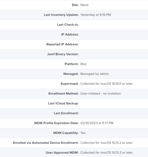

Since the 10.19 JSS update -or the 10.15.3 macOS update- something has broken where any Macs enrolled show up unmanaged. This applies to both DEP and user-enrolled Macs. I have the management account configured in both the PreStage enrollments and User-Initiated enrollments settings. I end up manually assigning the management account and then it's all good. I didn't have to do this before. Any ideas what might be happening or where to find a log that might say what's going on?

This is a semi old thread, but I've just run into this myself. It is not happening with all Macs. Our DEP enrolled Macs seem to be coming in just fine, but when doing a manual enrollment with the UIE process, the Mac shows as Unmanaged, and I can confirm that not even the Jamf binary is coming down to the device. I can't figure out what's happening with this. We're on Jamf Pro 10.25.1 on prem. Strange issue. And I need to get it resolved ASAP so I can enroll these Macs and have them properly managed.

Can anyone check their M1 Enrollment Profiles to see if the CA Certificate was installed when going through DEP-Prestage enrollment? I don't have much M1 Macs to test with but I believe the CA Cert doesn't get installed hence the macs not being managed.

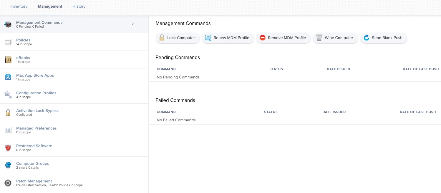

I tried to manually enroll one of them through our enrollment URL, but I've not seen it check in once since being enrolled (yesterday). Policies are all installed but are not being enforced, and I'm missing commands on the management tab. Is anyone else experiencing this?
Just to add, I don't see the JAMF Binary installed. There is no /Library/Application Support/JAMF directory.
