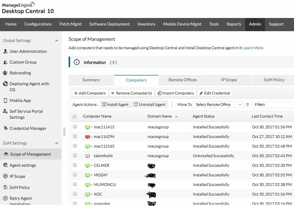

Really it is a good software. I am using in my company. I can install lots of software,patch via desktop central. I tried install desktop central agent to clients but it is not working. Still working on it.

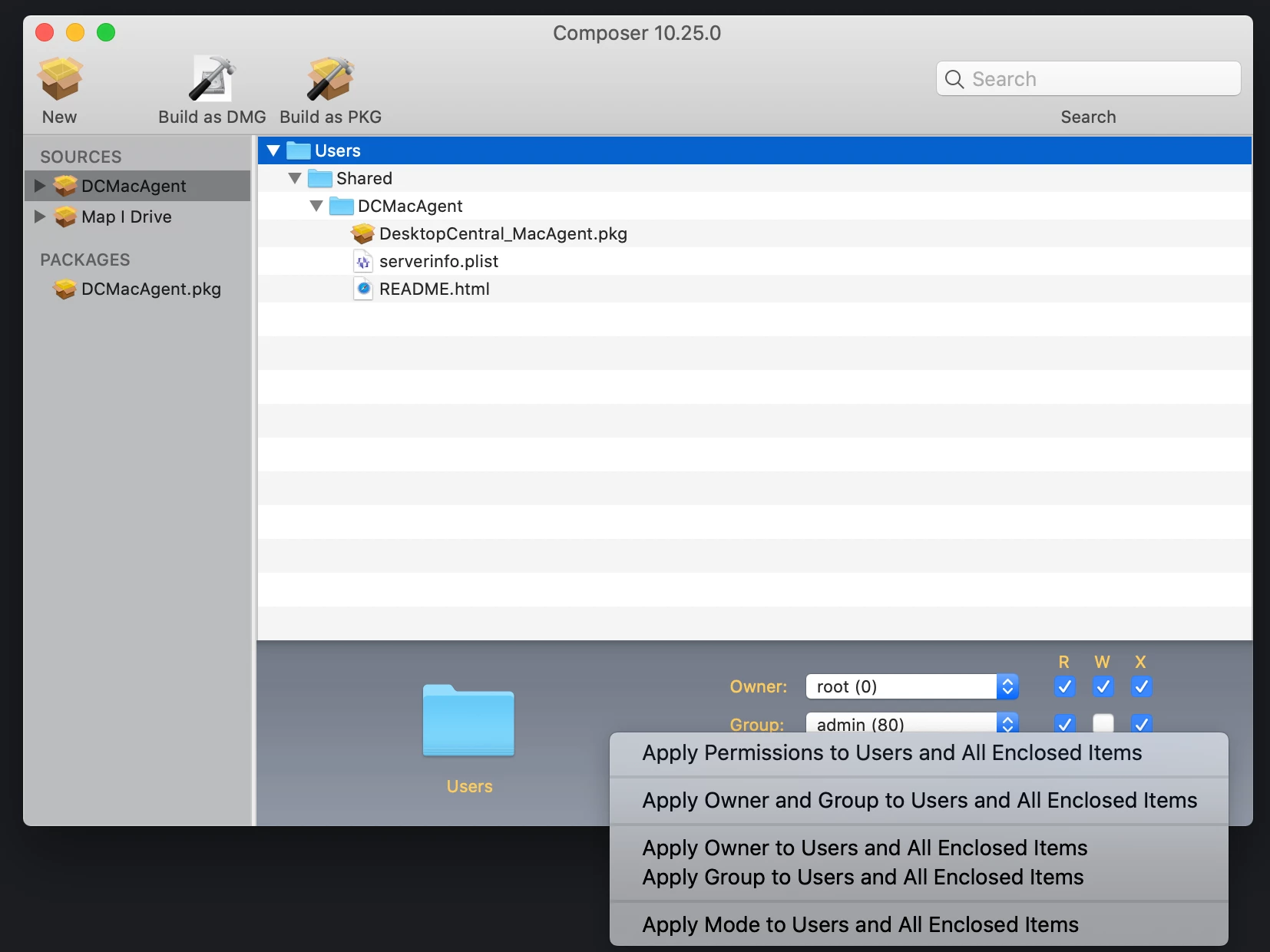

@ray.henry , I also use Manage Engine's DC and always run into issues using the agent. The only way to fix this issue is by re-packaging the agent on your own, here is what I normally do to package it via Composer:
1- Download the agent from the DC site
2- Open Composer and drag your package from step 1 into it
3- Create a folder structure as you see in the screenshot above
4- Package it 5- Copy the package to to your DP and create your policy
If this is a machine with an existing agent on it, you might want to configure Files and Processes in your policy so that the Agent restarts after the upgrade
And this is how the package looks like in Composer
Hope this helps

@user-gDwjmhTONC I believe that you should unpack it from the .zip and than drag it to composer.
  • October 15, 2021
I did end up putting the zip file into composer and create the package. However when I run the policy it doesn't install the package just puts it in the location that it was created from.
Did you follow my instructions above? it still works for me. Make sure you check the permissions. you might need to Apply permissions to Users and All enclosed folders

I remember this happening to me when the permissions on the subfolders did not match the root folder. That's the only thing that I can think of.
  • October 20, 2021
I have applied permission Owner:Root and Group:Admin to Library and all enclosed items.

Hi @rnoureddine, first thanks for the lead on how to set this up.
But looking at your pictures, the Composer .pkg that you create would only place the folder in /users/shared/DCMacAgent... It would not install the agent on the machine.  If you have the missing piece, it would be greatly appreciated.

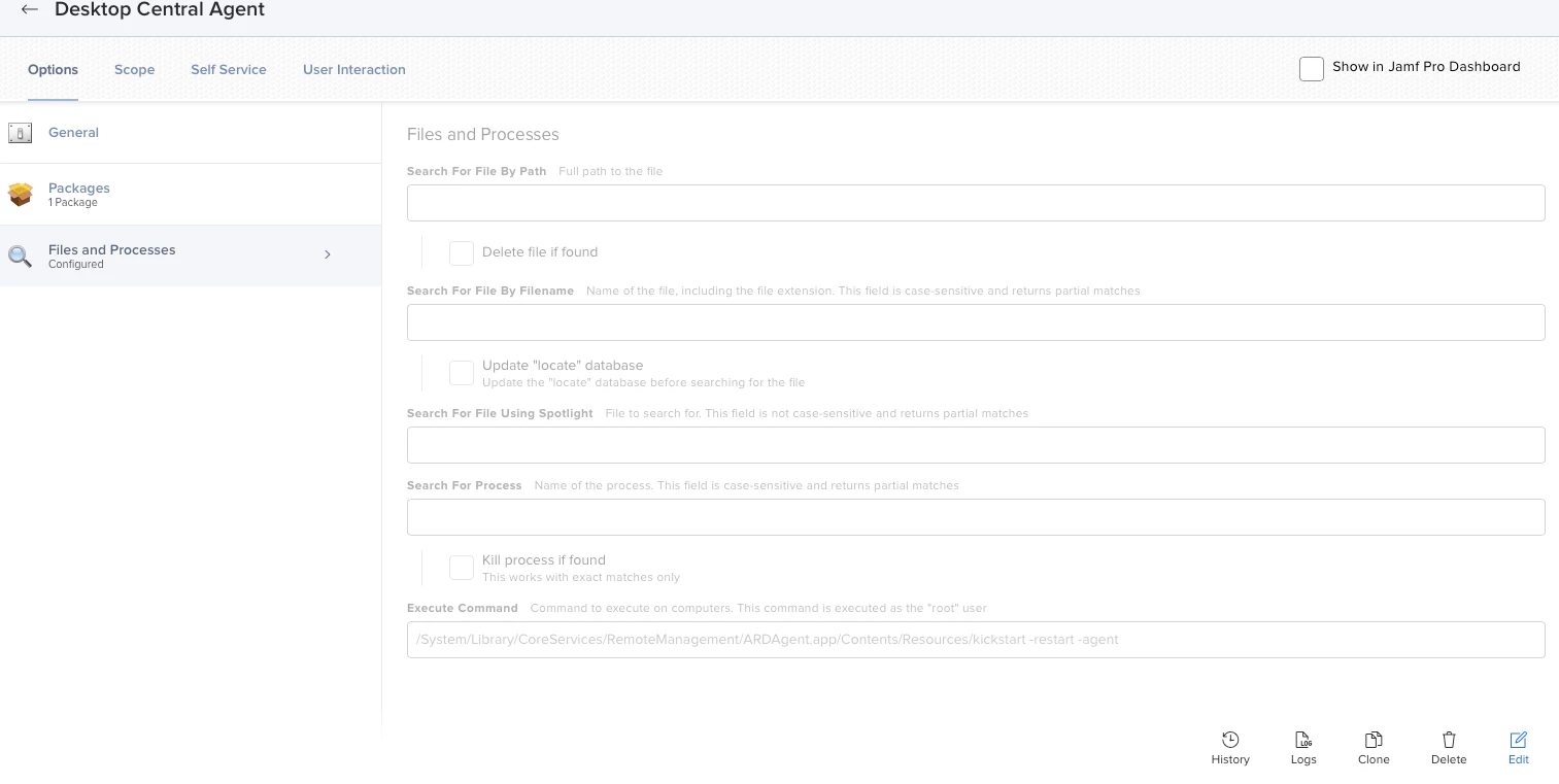

I have the package set to "install" in the policy and also have the File and Processes configured to execute this command
/System/Library/CoreServices/RemoteManagement/ARDAgent.app/Contents/Resources/kickstart -restart -agent

Got it.  I also have the package set to install… But since the .pkg we built is only placing the folder DCMacAgent into /Users/Shared/ when you install it that what it installs… It doesn’t actually install the .pkg that came from DC, it only places the DCMacAgent folder in /Users/Shared/
Anyways, I added
sudo installer -pkg /Users/Shared/DCMacAgent/DesktopCentral_MacAgent.pkg -target /
To Files and Processes and it seems to have worked.  I only have tested on one Monterey and one Catalina.

Yes, the installer command from the readme needs to be run.
I didn't need to run the "kickstart" command, and scan results showed up instantly in SDP.  If you have trusted communication enabled, you'll have additional files in the .zip file to include.  It doesn't need to be go in /Users/Shared, it can be anywhere, but you'll want to set the owner/group in Composer.
