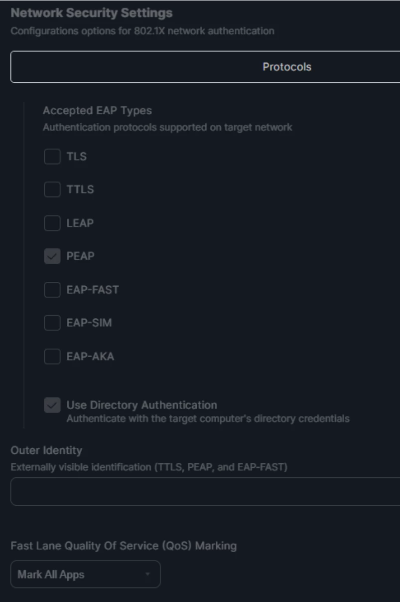

Anyone have ideas on how to get the client to consistently present the computer name during the authentication attempt? My understanding is that the 'Use Directory Authentication' option in the profile configuration should be forcing this. I thought I came across an article from back in the 10.10 days where this was discovered as a bug and fixed in 10.11, did it come back?

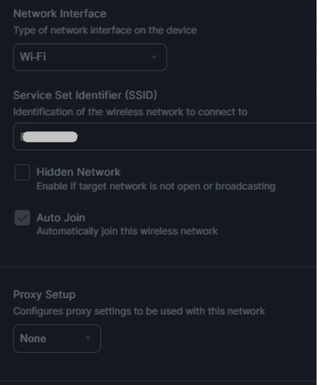

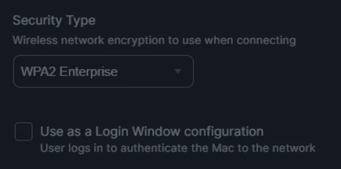

We are using Jamf to deploy network configuration settings to all Macs, below is the profile configuration
Profile Level: Computer Level
