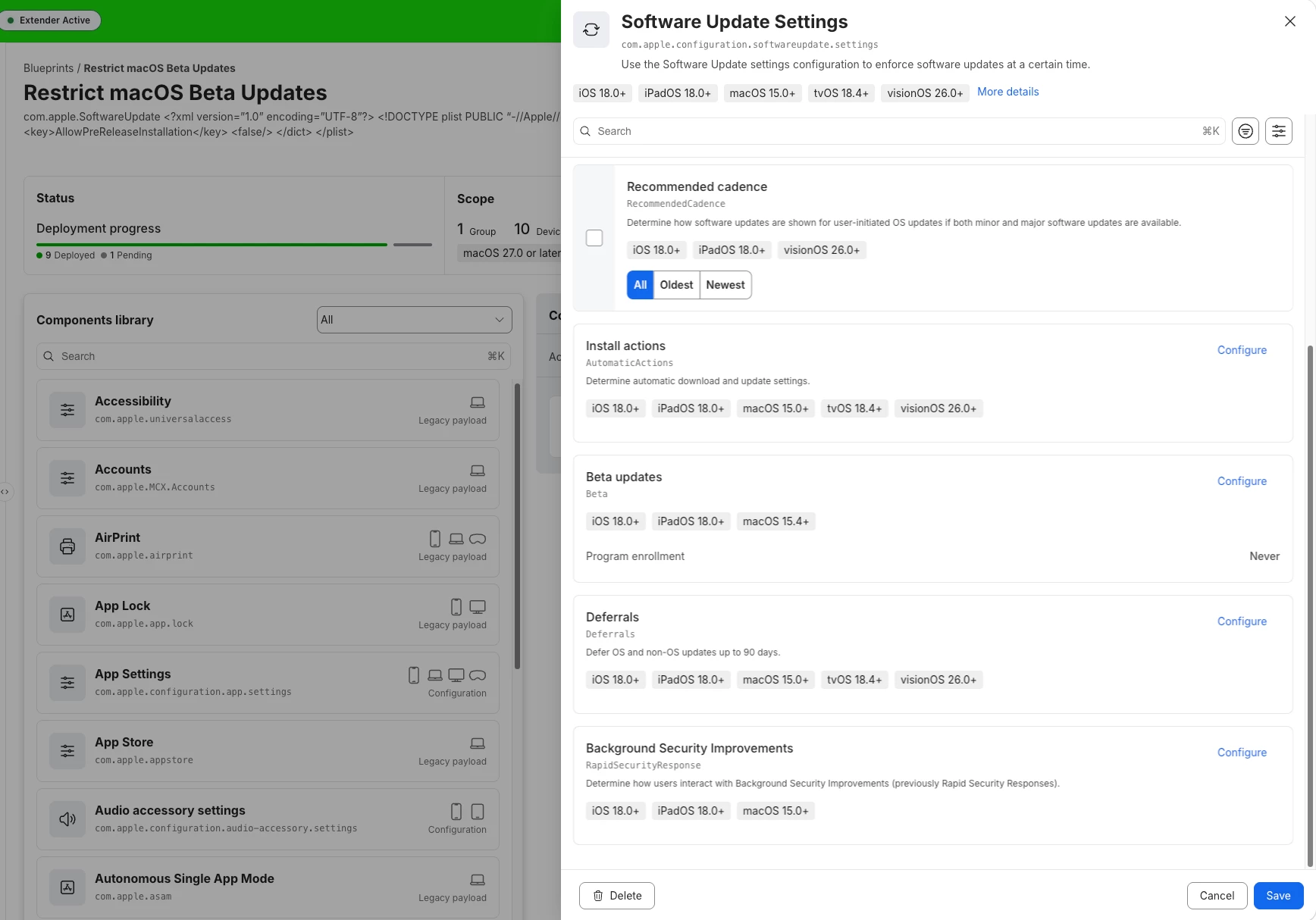

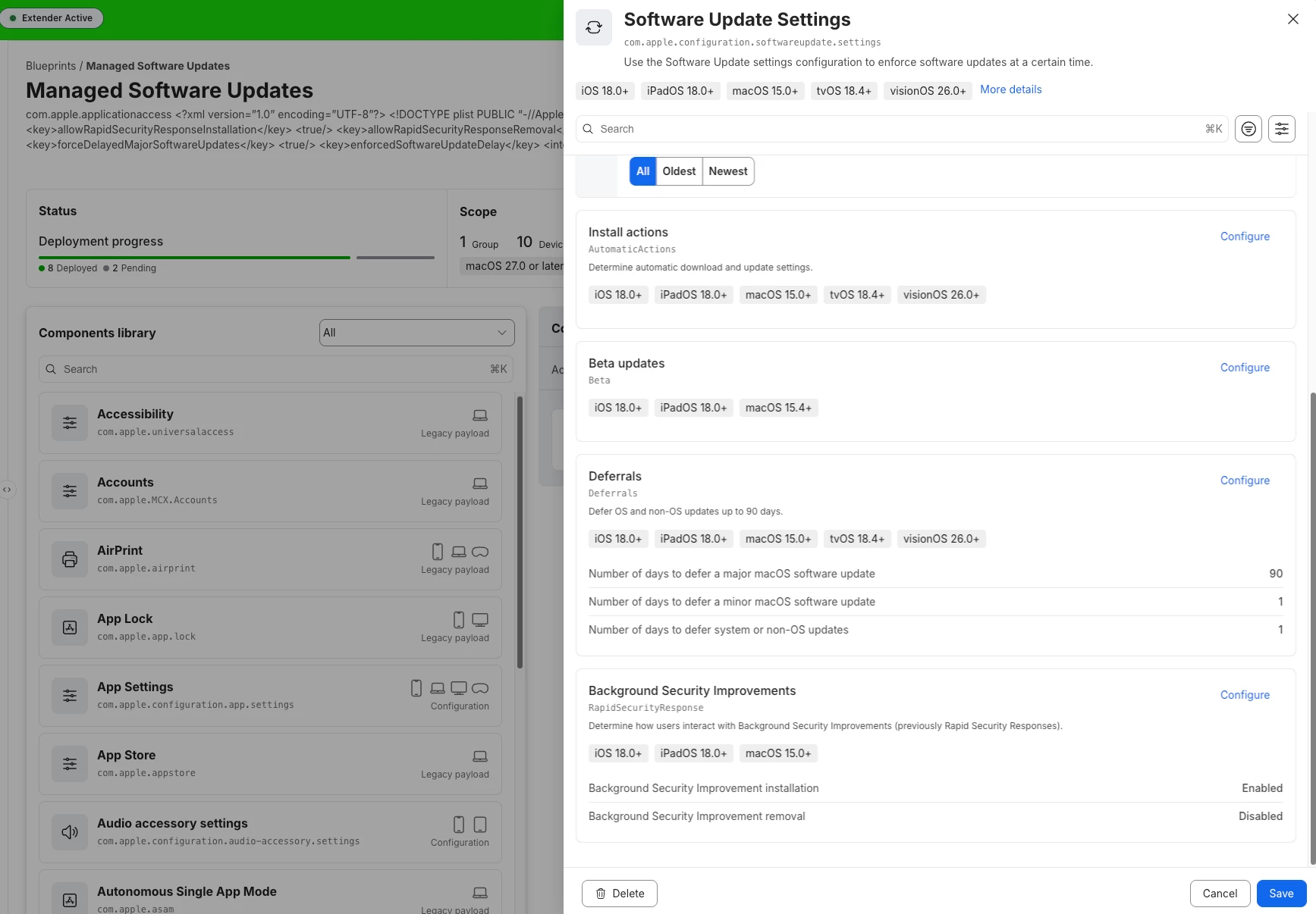

I need some help and have a question regarding how this works. I’ve just started deploying software update settings via DDM in my Jamf Pro production instance. I currently want to deploy four different blueprints—similar to the configuration profiles I used previously. I noticed that the MDM profile contains multiple entries for device declarations related to software updates, and settings are enabled there that I only actually configured in one of the blueprints. For example, I want to disable “Background Security Improvement removal”; I have explicitly disabled this in one blueprint, yet the setting appears as allowed in the other entries within the MDM profile. Can anyone shed some light on this? Two blueprints are visible in my screenshots. In one, the removal of “Background Security Improvement” is prohibited, while in the other, it is not set at all.

Wait so I’m confused. Whats the ask?
It seems the blueprints are doing exactly what they are meant to do according to your screenshots. BSIs aren’t available to be set via MDM configuration profiles, only RSRs (which I recently learned from an Apple rep are not the same thing).

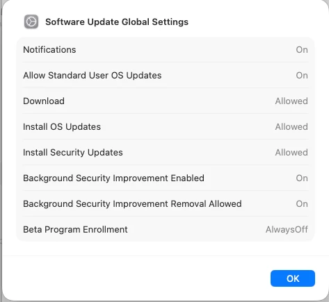

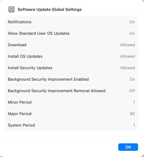

I would have assumed that if I neither enable nor disable it in another blueprint, it would simply be ignored.
We basically have 3 different statuses. enabled, disabled and not set. but in the mdm profile on the mac it appears as enabled if i did not set it.
does that make sense? i don't get it.

  • Sep 16, 2026 10:45 AM UTC
Ah yes. So unset takes the default configuration that Apple sets. If you have a declaration set though, it’ll respect that over anything/everyhing else.

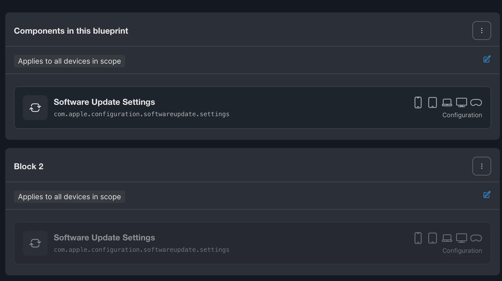

  • Sep 25, 2026 8:18 AM UTC
So, I’m ended up by doing one Blueprint with two component blocks and activations like ​@_gsm  recommend. This works! In the past i split Config Profiles for different purposes and scopes. In the JNUC 2026 Platform State of the Union: Blueprints, APIs & Mobile Luke explains the way: https://youtu.be/hrMK0wwgx_M?t=658
