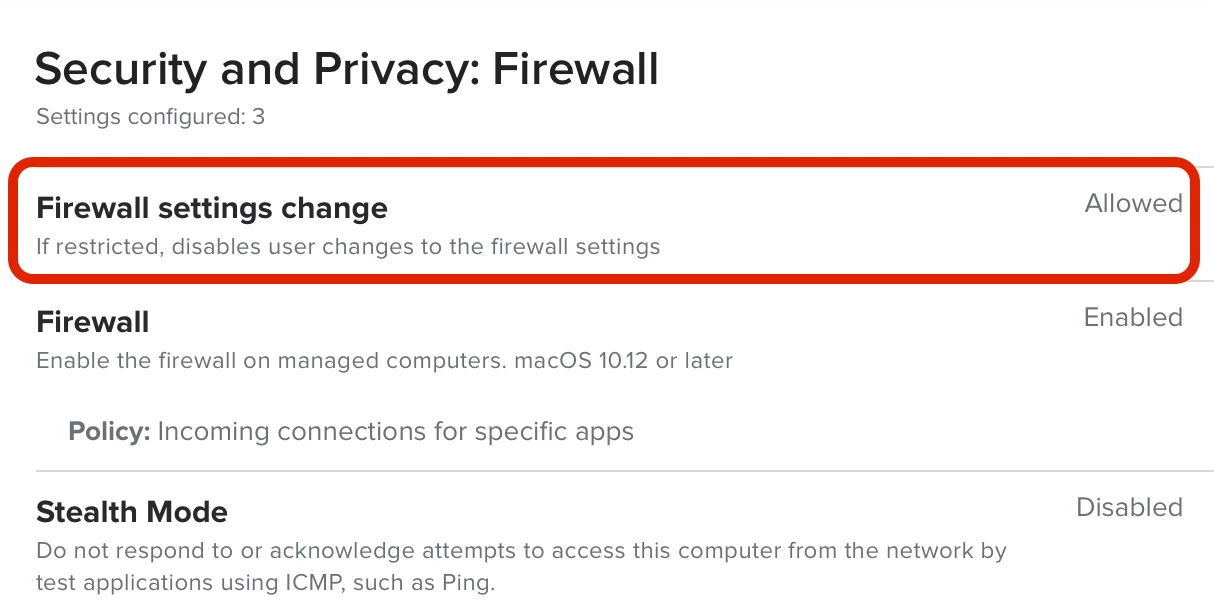

I am migrating my workflow of managing the macOS ALF firewall from scripts/policies to Jamf MDM profiles. Found odd behavior that prevents users from making changes.
Even though I have explicitly set the new ALF profile to allow users to modify ALF if needed (Jamf Privacy & Security > Firewall settings change > Enable user changes to the firewall settings), the ability to manage ALF locally is greyed-out (disabled) on my test Macs - even though the user is a local admin(and can authenticate to unlock the Security & Privacy pane.

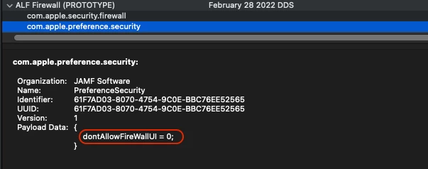

I'm in a similar situation here too. I migrated my ALF management from a script/policy recently to an MDM profile (required for macOS 12 Monterey).
When the ALF profile is scoped to my Macs, users are no longer able to modify any ALF settings. Local admins can unlock the Security & Privacy pref pane as expected, BUT the ALF button to "Turn Off Firewall..." is grayed-out - and they cant modify and ALF rules, either.
There is an explicit Jamf MDM Profile setting named "Firewall settings change (If restricted, disables user changes to the firewall settings)” which is disabled so that users should be able to make changes. This setting translates to the key/value pair of “DontAllowFirewallUI” when looking at System Profiler and the Profiles pref pane. The value is correctly set to 0 (disabled). But ALF can not be modified contrary to the value.

  • Mar 28, 2022 10:24 PM UTC
the dontAllowFireWallUI has existed since 10.10
https://developer.apple.com/documentation/devicemanagement/securitypreferences?language=objc
Is dontAllowFireWallUI the key/value pair you think is not working in macOS 12 Monterey?
Even if I create a stand-alone ad-hoc plist (domain = com.apple.preference.security) containing only the 'dontAllowFireWallUI' key/value pair and upload it to Jamf, the target Macs ignore this.
