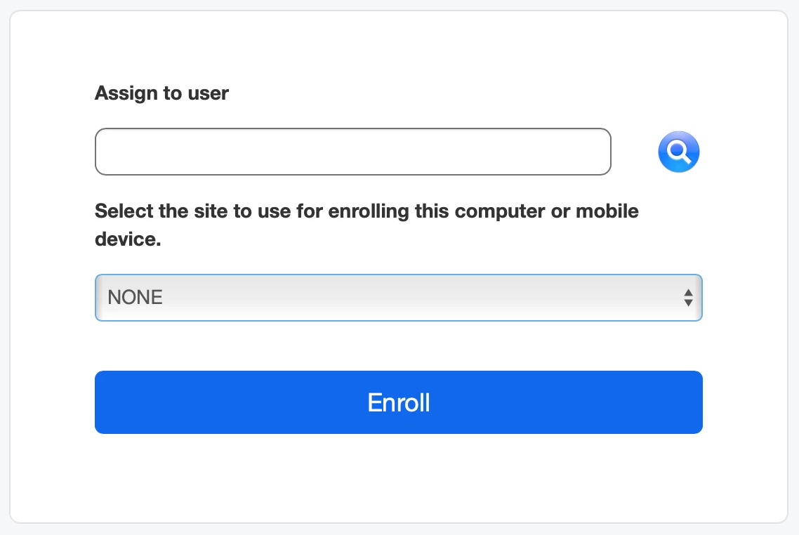

We have multiple sites in our Jamf pro because we are a group of companies. Now we want to assign sites during the prestage enrollment. So, when the user will connect a new laptop with the internet, then it should pop up an option with site names so the user can select which site he/she belongs. Based on that, he will receive the enrollment customizations and policies made for that specific sites.
It is working fine with user initiated enrollment but I can't figure out how to do that with prestage enrollment. Can anyone help?

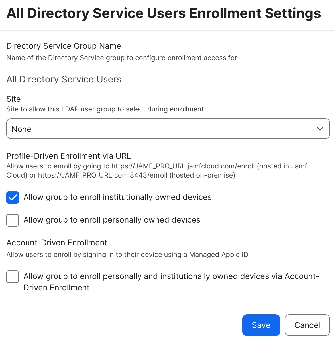

    There are LDAPS configured for all of the companies (6 as of now). But I am picking only the username and title for the maping because other fields are not required at the moment.
  5. Current User Workflow:
    Once I created the sites after connecting the LDAPs, it appeared automatically for the user initiated enrollment. See the pop-up and directory service user enrollment settings below:
    During the user initiated enrollment, they have the privilege to select a specific site by themselves.
