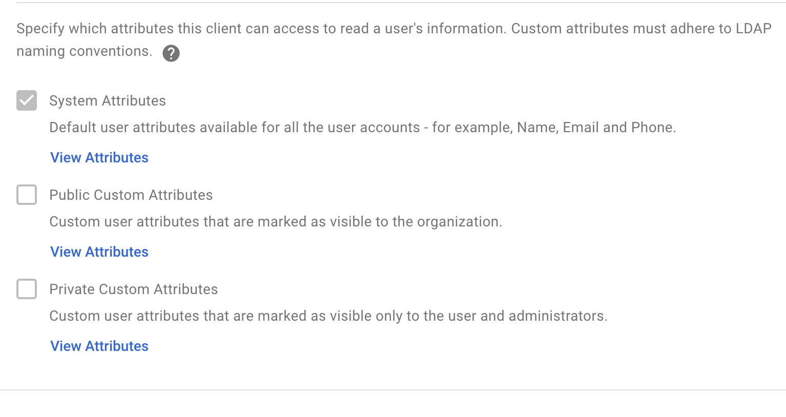

I re-read what you wrote. Regarding the Custom Attribute, make sure you have provided the permission in Google workspace.
Go to Google Workspace -> LDAP -> Jamf (whatever the name you set to) -> Click Access Permissions -> Check to see which attributes it belongs to and enable.
With that said, not sure why it needs a custom attribute instead of using Google's department field with "departmentNumber"
Lastly super important:
Make sure the all the names of the Department are created in Jamf's Departments setting.
It will show "No value" if name of the Departments are not created ahead of time.
