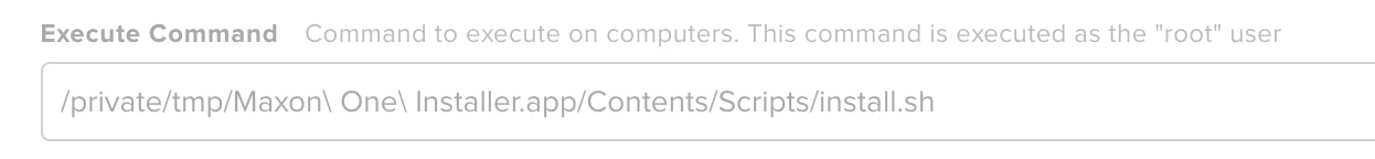

  6. Add a Files & Processes setting to the policy configured to the following
    1. <path to Maxon One Installer.app>/Maxon One Installer.app/Contents/Scripts/install.sh
  7. Save and run the policy

So I built three JAMF packages
  1. DMG installer
    1. Cinema 4D installed using Composer standard package installation capture process.
  2. DMG Installer
    1. Maxon App Installer.app located in /private/tmp/ -- Using Composer Drag & Drop
  3. DMG installer -- Using Composer drag & Drop
    1. com.maxon.mxlogin.agent.plist in /Library/LaunchAgents/
    2. MaxonAppLogin.command inside /Library/Application Support/Maxon/Tools/
When packaging the MaxonAppLogin.command you will need to run a chflags -hidden on the file before dragging the /Library/Application Support/Maxon/Tools/ folder into Composer. This will hide the command from regular users preventing them from grabbing your maxon account credentials.
Your MaxonAppLogin.command should look similar to this: /Library/Application\\ Support/Maxon/Tools/./mx1 user login -u <Your Maxon Account Username> -p <Your Maxon acct password>
The "./mx1" is for the hidden file to be called by the LaunchAgent
Do note that your Maxon Account password apparently can't contain special characters as it will get rejected by the command.
Installation process was as follows:
Created Smart Group for Cinema 4D being installed
Created Smart Group for Maxon App being installed with criteria "Cinema 4D package installed by Jamf"
  1. Install Cinema 4D DMG package - scoped to labs
  2. Install Maxon App DMG package with an additional command attached via the Files & Processes policy item - scoped to Cinema 4D Installed Smart Group
  3. Install the LaunchAgent & MaxonApp.Login.command DMG so it installs into the Maxon Tools folder.  - Scoped to Smart Group for Computers with Maxon App installed.
