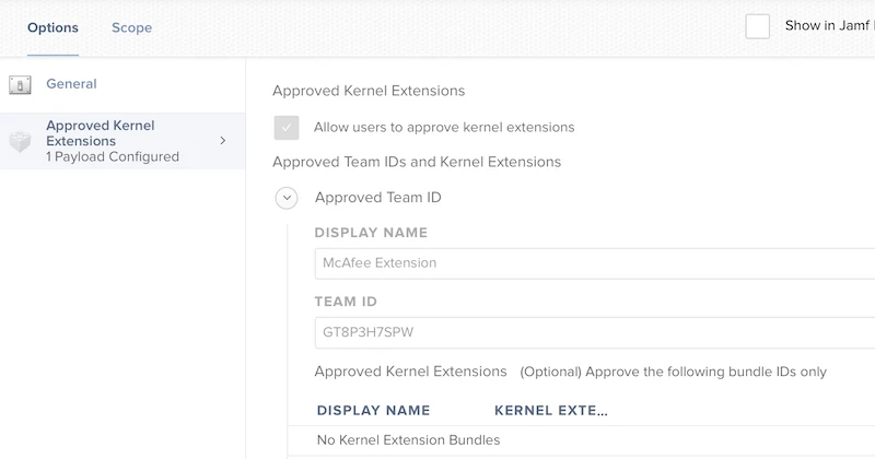

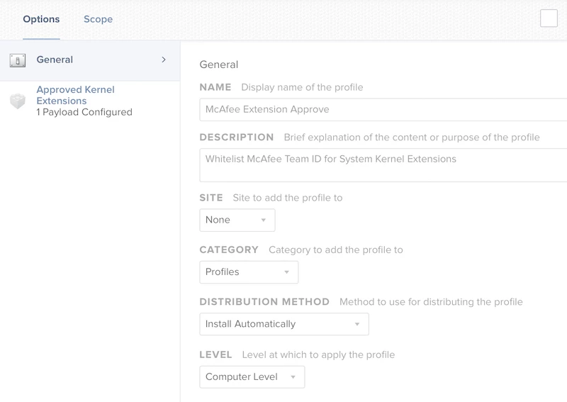

@scottb Have you found a way for the 10.2.3 install to complete without requiring the user to open the Security & Privacy prefs panel and Allow the McAfee software to load?
scottb
  • April 18, 2018
@sdagley
This is what I'm going to test later today. I have to nuke the Mac (behind on that) and run this. I don't know if it will work, but I'll post back...
sdagley
  • April 18, 2018
@scottb Ah, for some reason I wasn't thinking there was a kext involved. Yet another reason to upgrade the JSS to Jamf Pro 10
  • April 18, 2018
@scottb @sdagley
We do what ScottB posted and it works for us...
