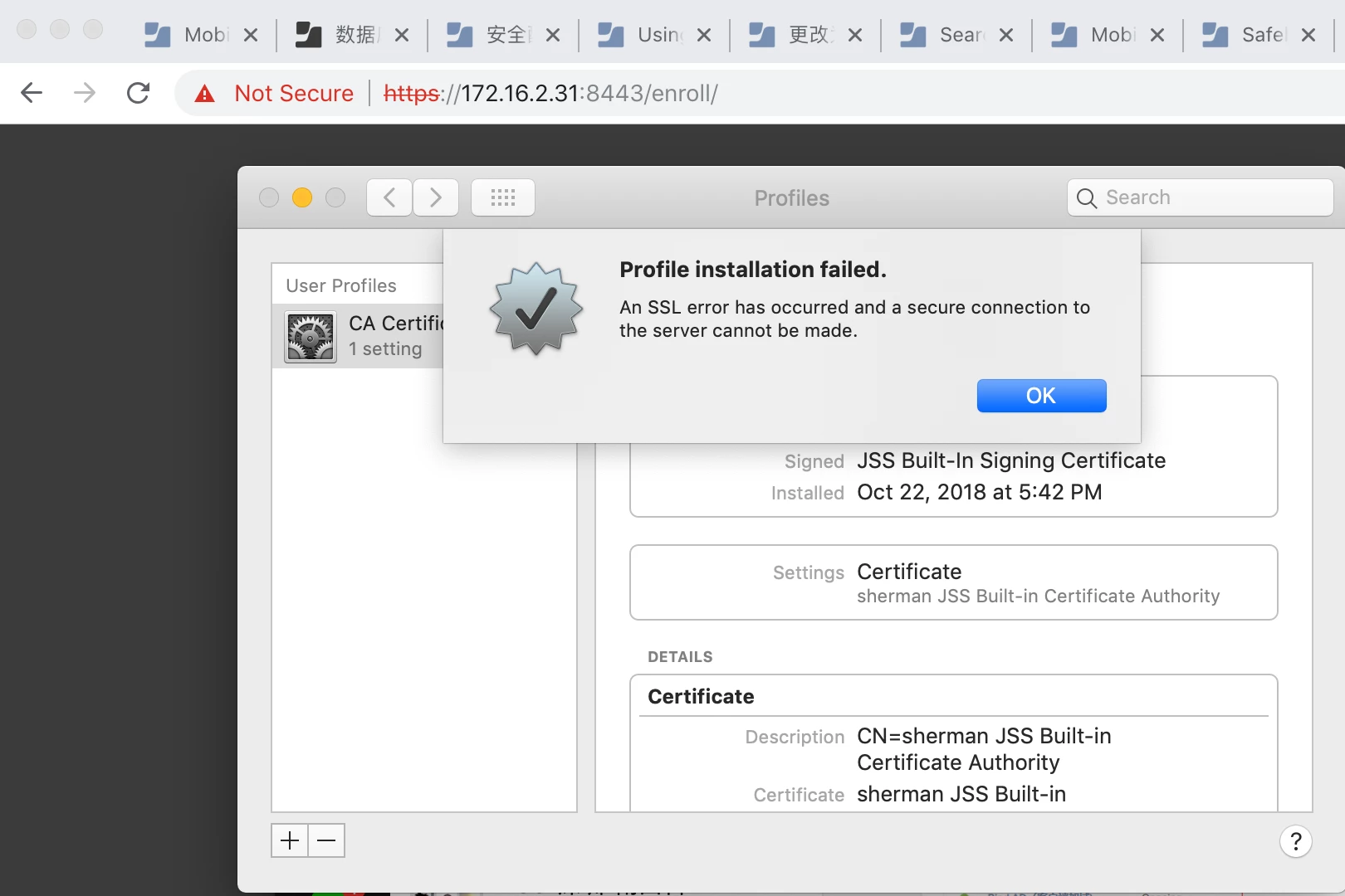

I want to use it in the intranet test for jamf, but when i enroll a computer the MDM Profile can't install.

I'd also be concerned about the Database connection error in your first screenshot.
Make sure your config file is pointing at the actual DB server instead of using the defaults.
For the SSL error, you can likely download the certificate giving you the error and importing it into your system keychain. You'll need to manually mark it as trusted. From there, try to re-enroll.

I think you may need a host name.

i user the domain name to link the server, it's working now. Thanks every!
