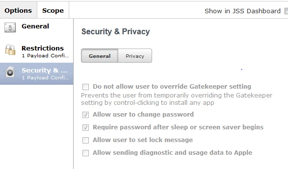

I'm looking to change the "require password" from Yosemite's default of 5 minutes, to immediately. Currently, some configuration profile or MDM profile is causing the option to be greyed out and I can't figure out what it is. Also, what is the difference between configuration profile and MDM profile? I understand that a MDM profile gets pushed when I enroll a machine into Casper -- is the MDM profile and configuration profile the same?

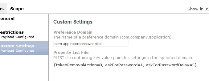

We have one configuration profile set, which locks down some settings in system preferences. I've tried checking the require password immediately with no luck, and also tried to manually edit my own plist to set it to 5 seconds and uploaded the plist file in custom settings with no luck.

I've also tried the custom proflile based on that thread. On the machine with the new configuration profile, it shows the forced policy but still sets the default as 5 minutes. I'm seeing that there is a configuration profile and a MDM profile on the test machine. It looks like the MDM profile also changes some system settings. Where and how can I change the configuration of a MDM profile? Can the MDM profile be overriding this change?

That looks exactly as mine does which is definately working.
