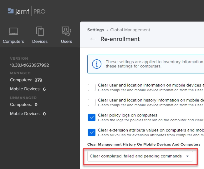

@DanJ_LRSFC  Under Settings->Global Management->Re-enrollment try changing the setting for "Clear Management History On Mobile Devices And Computers" to "Clear completed, failed and pending commands"
  • July 16, 2021
@sdagley I've just had a look at that setting, but it's already set like that.
