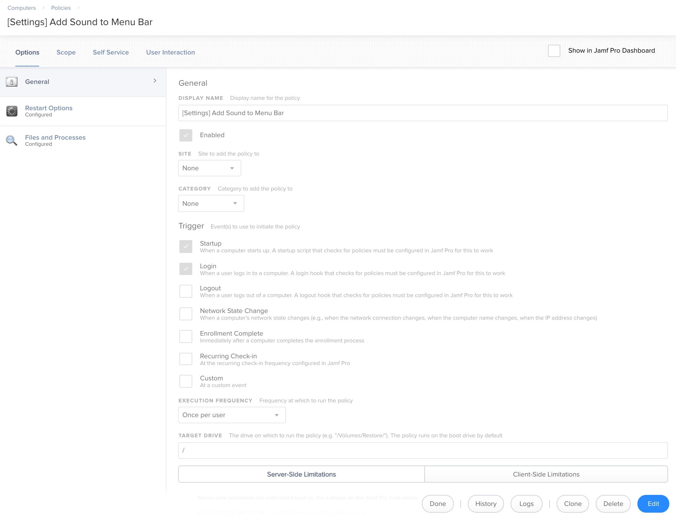

  • January 10, 2020
Works in Catalina 10.15.2
If you have it be Once Per User you should be able to avoid duplicates.
  • September 18, 2020
@larry_barrett Like your solution. Just some observations.
The Volume does not work under BigSur Beta 20A5364e. The Volume.menu doesn't work when just opening it from the GUI, while VPN.menu works both from JAMF policy and GUI. Some of the .menu files that resided in /System/Library/CoreServices/Menu Extras/ are no longer there (ie Bluetooth). Still looking for them...
I am hoping these are just beta issues.
I would also have the policy run at every login, I don't get duplicate icons for the VPN. Still testing the others.
