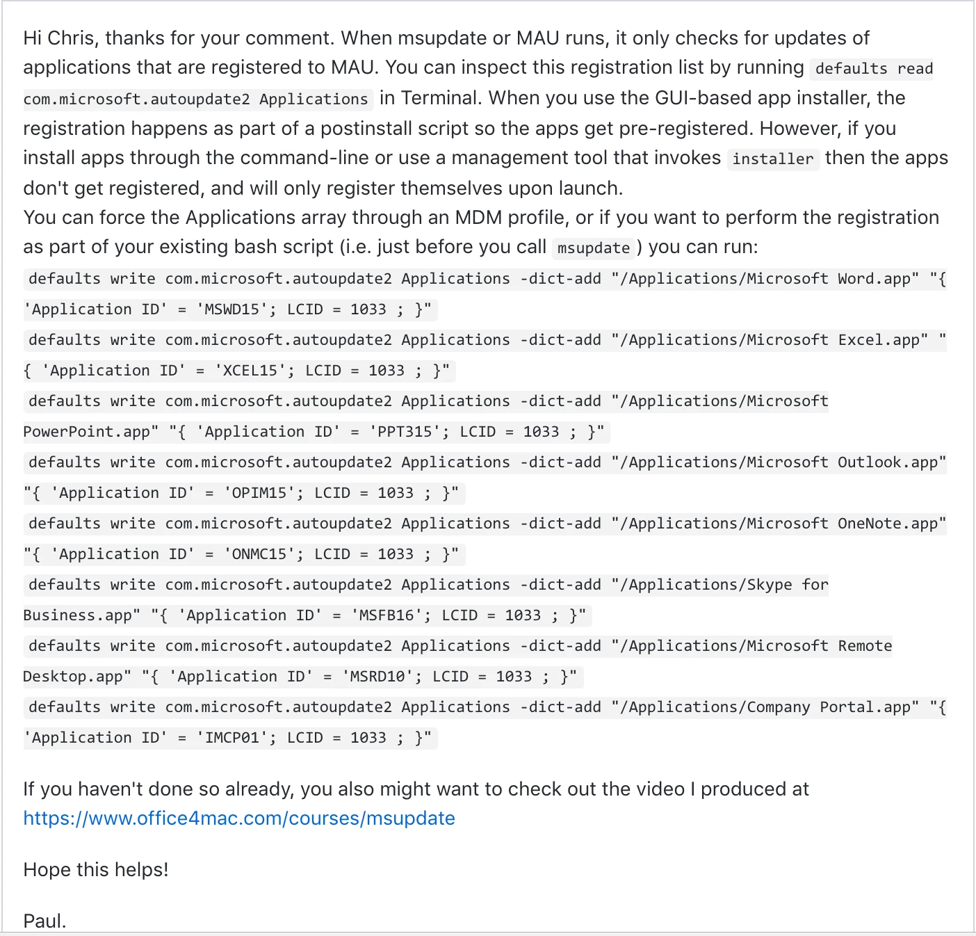

  • I am unable to catch updates for MS Office applications even after copying and pasting the correct plist file that has the registered applications in the Preferences folder. You can test this by doing a clean install of Microsoft Office 2016 and the Auto Update 3.18 or above. Then with using the binary or the Autoupdate app that is located in /Library/Application Support/Microsoft/MAU2.0/Microsoft AutoUpdate.app check for updates. It will show NO UPDATES AVAILABLE....
  • Paul Bowden from Microsoft was able to direct me to another way of correcting the plist file that should help msupdate find updates correctly but when I tested his method it ended up corrupting the plist file. =/ I am not sure why. Maybe if someone else tested this could they see if it works fine? I attached a screenshot of his solution here:

        echo "We are going to check for Updates"
        if /Library/Application Support/Microsoft/MAU2.0/Microsoft AutoUpdate.app/Contents/MacOS/msupdate --list | grep "No updates available"; then
            echo "${binaryruncheck}"
            echo "There are no updates available."
            osascript -e 'display notification "There are no updates available." with title "MS Office is up to date!"'
            echo "This script will now close."
            exitProgram
        else
            echo "There are updates available"
            osascript -e 'display notification "There are updates available for your Microsoft Office" with title "Updates Available!"'
            updatesavailable=true
            installUpdates
installUpdates() {
    echo "Running the installupdates Function..."
    echo "Updates are available is $updatesavailable"
        if [[ $updatesavailable == true ]]; then
            echo "We are going to install the updates available for MS Office 2016."
            /Library/Application Support/Microsoft/MAU2.0/Microsoft AutoUpdate.app/Contents/MacOS/msupdate --install
            while /Library/Application Support/Microsoft/MAU2.0/Microsoft AutoUpdate.app/Contents/MacOS/msupdate --list | grep "Updates available:"; do
                echo "There are updates currently queued up and being installed."
                sleep 300
                let installcounter=installcounter+1
                echo "$installcounter"
                    echo "There are no more updates available. We are breaking the while loop."
                    break
                if [[ installacounter -gt 5 ]]; then
                    echo "Please check if updates were installed. We are now closing the script."
                    exit 1
                osascript -e 'display notification "Updates are still being installed onto the computer for Microsoft Office." with title "Please wait as updates install..."'
            done
            checkForUpdates
exitProgram() {
    echo "Thank you for keeping Microsoft Office up to date! We will now exit the script."
    osascript -e 'display notification "There are no updates available. Thank for your keeping Microsoft Office up to date." with title "MS Office is up to date!"'
## MAIN CODE RUN
mainProgram
## END OF SCRIPT
Any input would be greatly appreciated. I help administer about 150+ macs with JAMF and this script would be a game changer. Apologies for the length of the post and script! haha if you want to rewrite please feel free. Thanks!
