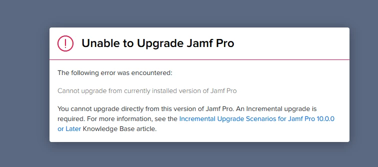

Hi all
We have installed latest version of jamf pro on a new virtual machine. The server was running fine so when we decided to restore it, after the database restore we get this message.
The source is a mac mini and OS is big sur v11.6.8 and is running jamf pro 10.27.0 and server tools 2.7.7.
Target is a VMware virtual machine and OS is ubuntu 22.04.2 and is running jamf pro 10.43.1 and server tools 2.7.14.
Is it because the database version is an older version?
appreciate any help.

I think you need to follow the upgrade paths here> https://learn.jamf.com/en-US/bundle/technical-articles/page/Incremental_Upgrade_Scenarios_for_Jamf_Pro_10-0-0_or_Later.html
Thank you for your response
We are aware of the incremental upgrade. but the issue here is not an upgrade issue as the target machine has the latest version of jamf pro running. which was running fine until we used a back up from an older jamf version which comes from the source. This method is actually
supported according to this instruction (https://learn.jamf.com/en-US/bundle/technical-articles/page/Migrating_to_Another_Server.html) method 1

What @AJPinto said (and what @Keith_L said regarding the incremental upgrades).
The "Method 1: Migrate to the new host server when all software is up to date" migration means _both_ JSS instance are up to date and running the same version. You cannot migrate a backup from JSS 10.27.0 to JSS 10.43.1, and you'll need your VMware hosted JSS to start with JSS 10.27.0 just like your Mac mini hosted instance, then upgrade the VMware instance through the incremental steps to 10.43.1

Jamf upgrades make changes to the database schemas, especially when going from 10.27 to 10.43.1. I know because we recently upgraded our on prem Jamf Pro from 10.26.1 to 10.42.1. I think the only way to do this is to install 10.27 on your VM, migrate the DB from the Mac mini to the VM. Assuming that's successful, then you should be able to perform the incremental upgrades on the VM to get it to the latest version, or whatever version you're wanting to upgrade to. You're trying to move it and upgrade at one time, and I just don't think that's going to work.
I dont believe you are correct in the meaning of Method 1. If it is doable is a whole other matter.
Method 2 seems more like how you understand it.
bottom line is that the migration instruction does not take into account the patch legacy that could happen like in our case. We agree it is never smart to be so far behind on patch level but thats how it is
i have installed the target with the same jamf pro version. database restore was successfull
connect to the webinterface and it started to do some activity with a progress bar. after a minute it stopped with the message
"Fatal error logged during server initialization: There was an error updating the database schema. Contact JAMF Software Support."
Jamf suport requested the JSS logs which has been attached to our case
Edit: I posted my response above before I saw both @AJPinto and @sdagley 's responses, which are both saying the same thing I just did. That seems like a unanimous opinion to me. You're going to need to follow the steps outlined to get this to work.
we have tried to install same legacy version on target now. we came further in the process but not in goal yet.
