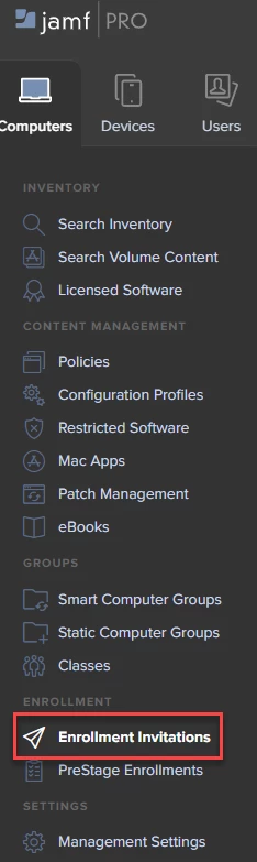

That last part, are you going to have some sort of mechanism to trigger an enrollment like the device isn't compliant? I've used conditional access policies to block access to resources unless they're enrolled with Intune as this also requires Jamf. But to my knowledge, I don't know if there is any other mechanism to automatically trigger an enrollment prompt once they drop out of Intune. My advice in this situation would be to send instructions on how to remove the Intune MDM profile and install the new Jamf MDM profile, and mass mail enrollment invitations from Jamf to your users. I hope this helps. Test and double-test the instructions being sent to make sure your #1 customers in your ticketing systems can follow the instructions without problems 🙃.
