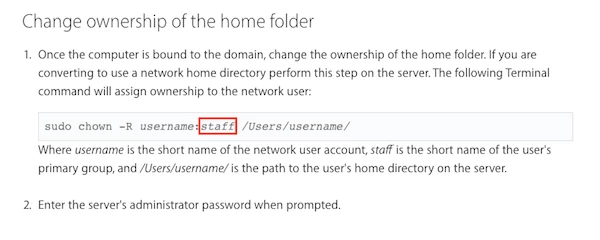

https://support.apple.com/en-us/HT202506
This article has all the ingredients to help you with this.

@stevewood wow, can't believe Apple's article doesn't mention using Domain instead of staff. I submitted a bug report to get that changed...
