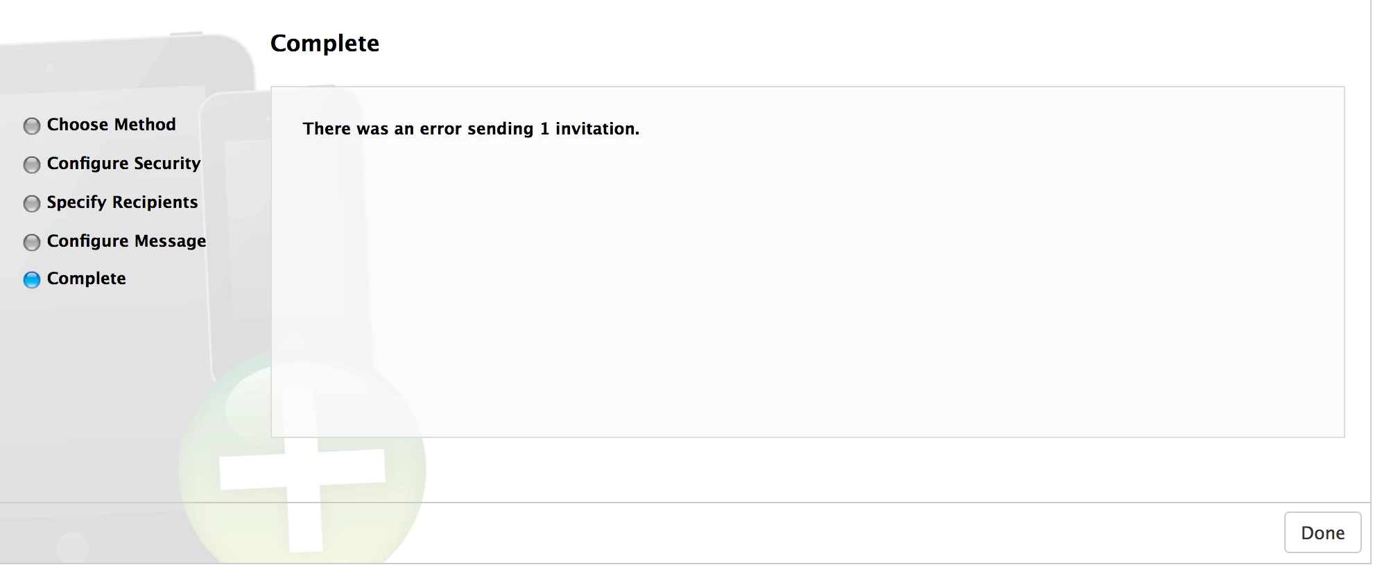

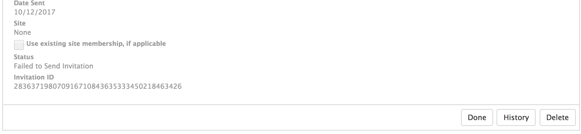

We are attempting to create an enrollment invitation to connect a few iPads purchased outside of our DEP agreement, but every attempt ends in failure. The result is always "There was 1 error sending invitation" with the status "Failed to send invitation". History doesn't show anything. Some previous posts direct to a resend option but I cannot find it. Anyone else having this issue?
