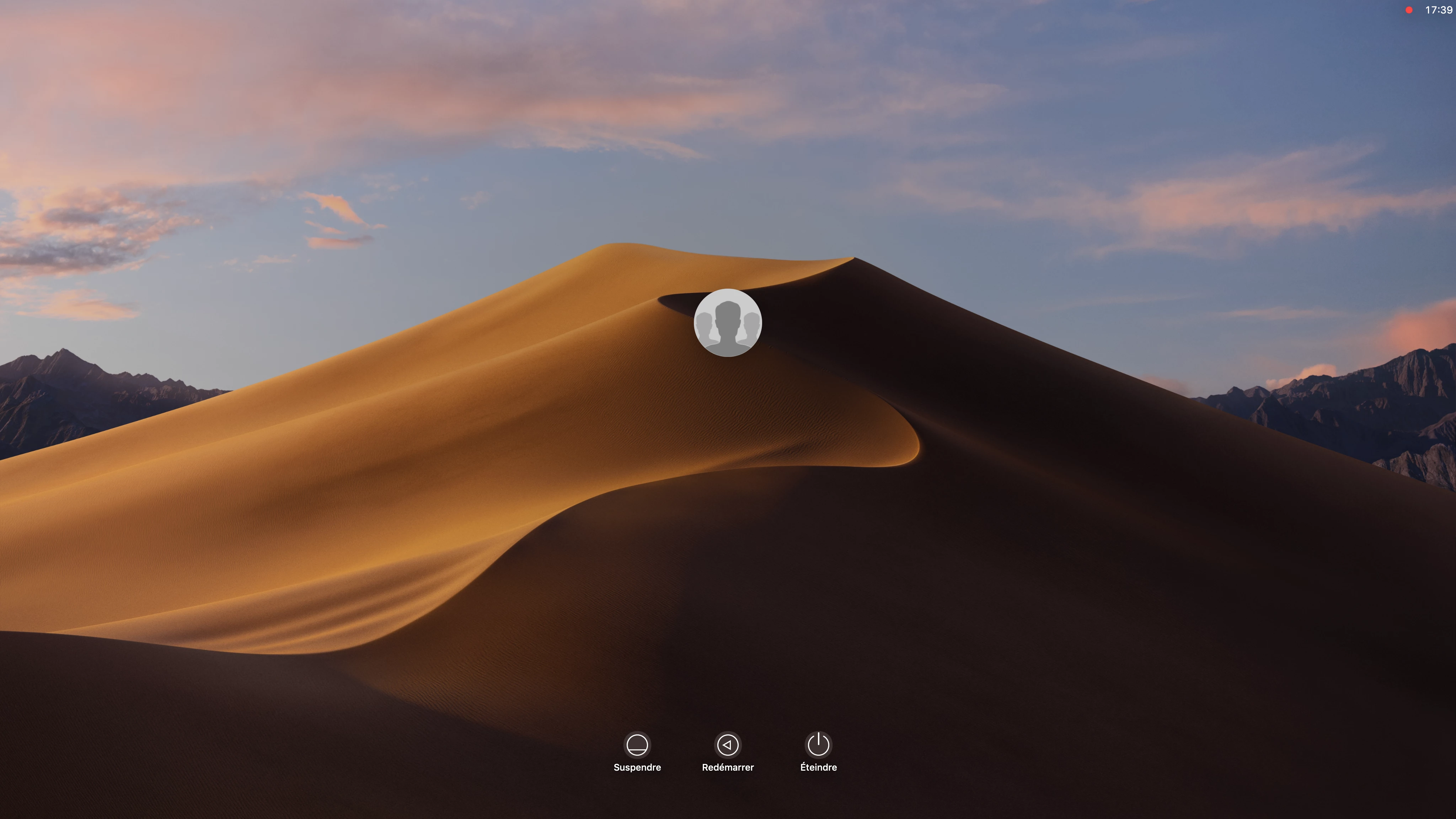

Hi,
I have a problem with MacOS Mojave when I have 'Login Window' payload with "
Show computer's administrators" unchecked.
Computers with only administrator accounts can't log in because no login/password fields appears.
Have you ever had this bug?
MacOS 10.14.2
Jamf Pro 10.7.1 (the same with 10.8 in Dev environment)
Thanks

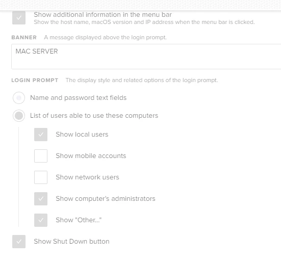

dletkeman
  • January 23, 2019
I had the same issue but after fiddling with it I think it was just working as logically intended. I'm not sure about your setup but for me I was configuring some servers that just use one local admin account for everything. By leaving "Show computer administrators" unchecked it was doing exactly as intended. Since there were no users to show I got a screen the same as you have in the first post. It drove me crazy until I checked the "Show computer administrators" box and everything was fine after that.
At first I thought it was a bug but after thinking about it a bit I came to the conclusion that this was logically correct.
Your experience may vary.
My settings here:

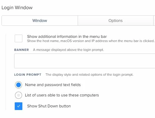

  • January 23, 2019
@Merkley I tested the script with Name and Password text fields as a configuration profile, and that did not work either. It already has SHOWFULLNAME = 1 when I read it. Are people not using a login window configuration profile at all here? If not, then maybe we need to unmark this as "resolved".
Here's what I'm using now, which was close to the original login window settings that worked perfectly fine on High Sierra and below. It also has SHOWFULLNAME = 1 on it as well.

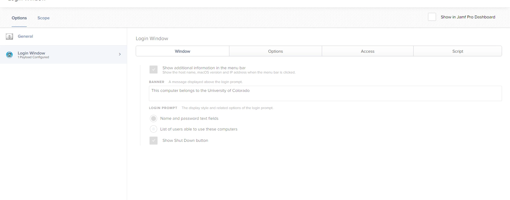

  • March 26, 2019
Is there anything new on this issue? We have a lab with about 30 iMacs all running 10.14.3, all domain-bound. We have always used the config profile to show the username and password fields rather than list of users because in addition to the fact that our users log in with their AD credentials, we would prefer that our local admin not be visible. Recently we've noticed that after the lab computers do their daily reboot, random computers will revert back to showing list of users, which only shows our local admin and then the "other.." option. This is not ideal as we can't expect our users, who are of the general school public, to know that they need to click the "other..." to login using their AD account, and again we would prefer that our local admin is not visible. If we choose to hide admin accounts, then we get the issue described in the OP.
I am also running the
defaults write /Library/Preferences/com.apple.loginwindow SHOWFULLNAME -bool true
command once per computer, but does not seem to have resolved the issue either.
Any help would be much appreciated. Thank you!

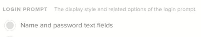

  • March 28, 2019
I switched my Login Window to "Name and Password text fields"
