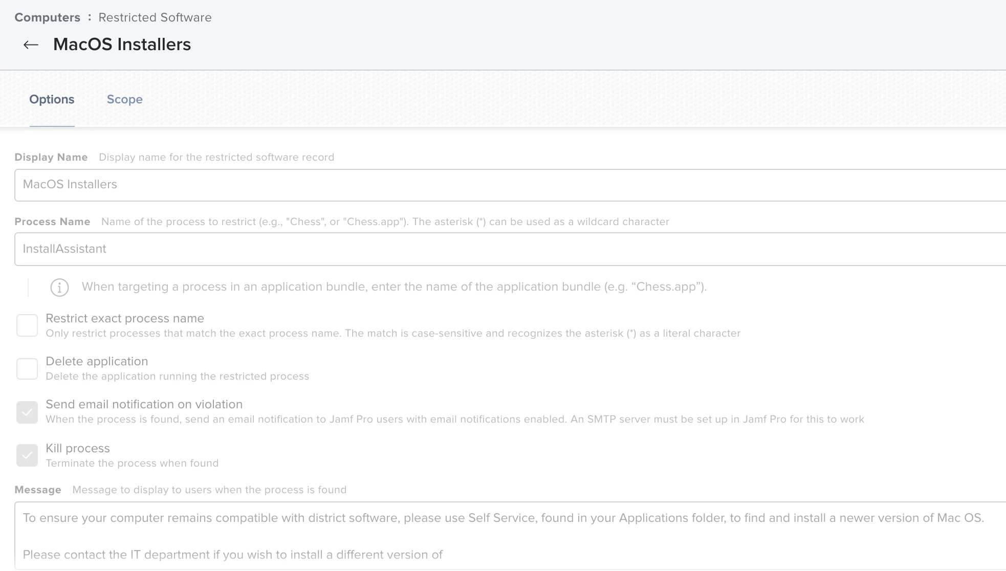

Best answer by Tlehr
Hello MrHacker,
Are you trying to block just macOS Monterey, or block any major OS installation? We use a software restriction that kills the "InstallAssistant" process , scoped to all managed clients, which covers any macOS major upgrade. This still allows users to install software updates/security patches freely. We then utilize Self Service to allow our staff to upgrade to the newer OS once we have everything tested, or at the end of the deferral period of 90 days (Since with Big Sur, you can now only defer up to 90 days and cannot use the software --ignore "macOS" flag anymore).

Hello MrHacker,

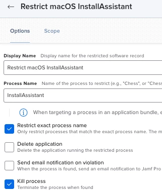

sara_mccullar
  • October 27, 2021
This is how I restrict Monterey without restricting computers to update to Big Sur if on Catalina/Mojave

What else does this impact though? A majority of my users are admins, what else would this potentially kill? ONLY macOS installers?
  • October 28, 2021
This only should impact macOS Installers. This process only runs on a macOS Installer.app launch. There are a couple ways to get around this for your admin users. You can scope a static group (one you create with your admin user machines designated) to the exclusion, which will allow any computer in the exclusion to run the macOS installers still. Another way to handle this is creating a Self Service Upgrade policy, which will allow you to scope a macOS Monterey upgrade to any computer of your choosing.
In our School District, macOS Installers are restricted across the board. We utilize Self Service upgrade policies to upgrade major macOS versions. To test macOS Monterey, I add my other admins/coworkers to the (macOS Installer Restriction) exclusion list.
  • October 28, 2021
