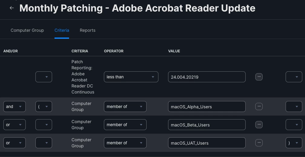

We have 12 Patch Reporting smart groups set up using “Less Than” and the version we’re deploying. We deploy to 4 groups on different days: Alpha, Beta, UAT, Wave 1, and Wave 2 (Execs/Traders). One Deployment Day, I update each smart groups by adding the next test group using parentheses and the “or” option. We use AutoPkgr for package downloads but can’t use autopkg jamfuploaders due to DLP restrictions. We currently can’t have apps autoupdate and have to manage the updates on a monthly basis. Modifying the 12 groups takes about 15 minutes to do, but I’m looking for a more efficient solution.

@talkingmoose Here is what our typical patching smart group looks like. On deployment days, we add the each test group. On the prod day, we remove the 3 test groups and then add another computer group using not a member of and add our executives. Then wave 2, we remove all computer groups. From some testing, it looks like I can't point to a patching software title. I'm currently trying to test by using application title and test groups.

Here is where I'm at. I was able to create the first API, that adds that has our patch reporting title, less than and current version we're using and our alpha group using and option and member of. This works, when I deploy the update the device drops out of the group. I have a second API that now adds the Beta group using the or option and still has the alpha group. I set the opening parenthesis for alpha and the closing for beta like the example above, I get the below error. If there isn't a way around, I just use the API to just add the one group that is getting the deployment. This is also posted in jamf-api channel in slack.
"code": "INVALID_FIELD", "description": "Uneven number of opening and closing parenthesis",
SMR1
  • Oct 30, 2024 7:58 PM UTC
Here is the body, I'm trying to use.
"name": "Monthly Patching - Google Chrome Update - A",
"criteria": [
"name": "Computer Group",
"priority": 1,
"andOr": "or",
"searchType": "member of",
"value": "macOS_Beta_Users",
"openingParen": true,
"closingParen": false
"priority": 2,
"andOr": "and",
"value": "macOS_Alpha_Users",
"openingParen": false,
"closingParen": true
"priority": 3,
"andOr": "and",
"value": "Monthly Patching - Google Chrome Update - B",
"siteId": "-1"

  • Oct 31, 2024 3:14 PM UTC
@talkingmoose
I copied what you posted above and after I added the dependency groups, your JSON worked for me.
If you're receiving a message about uneven parentheses, sounds like you're missing one somewhere. You might try using an online JSON validator to help you review you find it. There are several online.
For someone not very familiar with the Jamf Pro API, I can tell you've done a lot of homework.
If you can post your script online somewhere (GitHub has a nice "gists" feature) and post a link here, I'd be happy to take a look at the whole thing.

  • Nov 5, 2024 2:34 PM UTC
I pasted the below, but switched the beta group to use the closingParen and Alpha to use the openParen in the a json validator and it said everything was fine. When I run it via our jamf/api site or from the jamf/ api script it creates for me, it says uneven. I'll post a script, but it's pretty much the settings below.
