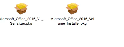

We have the Office 2016 Volume license. I wanted to test the use of the VL Serializer pkg. I am unsure as to how the Serializer is supposed to work. When I install one of the office pkgs, then install the VL Serializer my Office apps are not active. Are my user supposed to "Activate" office even after installing VL Serializer?
I do have the Office 2016 Volume Installer but want to have all my bases covered.
What am I doing wrong?
Thanks
Best answer by talkingmoose
@CapU, AutoPkg downloads updates not full installers. To use the VL Serializer tool, you'll need to download and deploy a full installer.
I recommend you get the SKUless installer from http://macadmins.software. Install it and then install the VL Serializer. You'll have a fully up-to-date and licensed installation.
