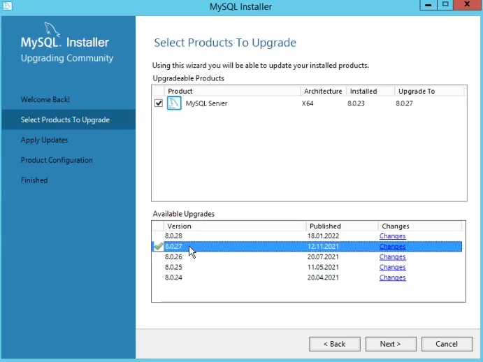

While installing using MSI installer 8.0.27.1 it automatically chooses 8.0.28. If you click on "MySQL Server" you can choose what version you want to install from the available upgrades. Hope this helps, if it's the same problem.
