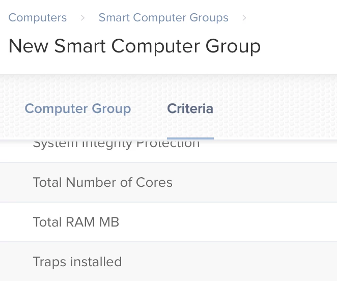

  • August 3, 2019
I am new to this, please help..
i got as far as creating the EA for this script, but when creating the smart group, what do i need to put in for "operator" and Value.
thanks!
Forum|alt.badge.img+15
  • April 11, 2020
