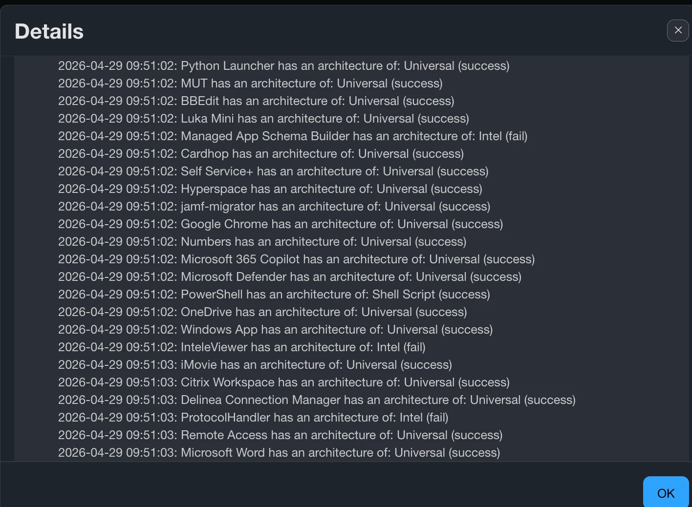

Apologies this isn’t cleaner...the concept was also lifted from Scott Kendall.  You can use this and then query it via an EA or just view the logs.  Just depends on how you want to do it.

This is what the logs look like:
You can most likely parse the script to report multiple ways, this way just worked for us.
The only reason why we didn’t use an EA was because it runs on EVERY check-in which can slow down check-in times and fill up database fields, slowing your instance down.
