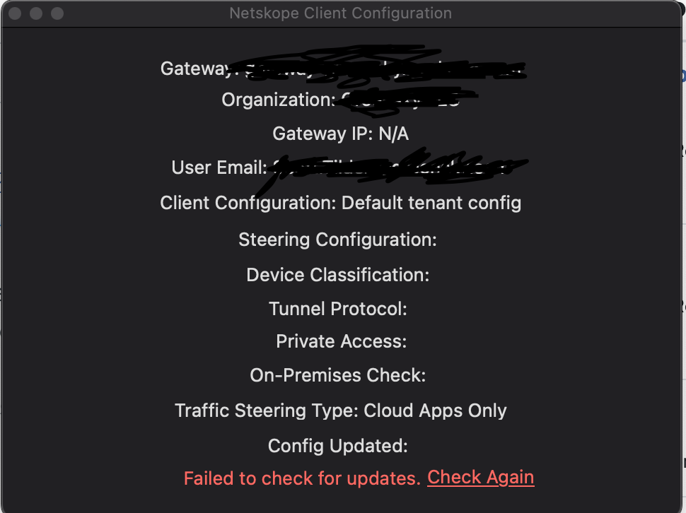

Has anyone seen any issues with deploying Netskope on Big Sur with intel Macs? We have tried both with Kext and Network Extensions and the agent is greyed out and the configurations do not appear. Currently have a ticket with Jamf engineering. We are using the latest version of the deployment script but are having no success. Netskope keeps directing using to their support page for the answer.

Yes, we haven't seen a Netskope build yet that fully works on Big Sur. Our configurations appear but the client isn't functioning correctly, on Intel or M1. We have a case open with Netskope on this, it sounds like they are working on an updated build.

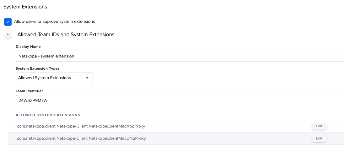

You should deploy a configuration profile allowing the system extensions BEFORE deploying Netskope.
System Extension Configuration Profile as follows:
System Extension Type: Allowed System Extension
Team Identifier: 24W52P9M7W
Allow System Extensions:
com.netskope.client.Netskope-Client.NetskopeClientMacAppProxy
com.netskope.client.Netskope-Client.NetskopeClientMacDNSProxy
  • Jan 7, 2021 8:37 PM UTC
Echoing what @Phantom5 said, make sure the system extension profile is there before running the Netskope installer.

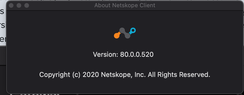

Also, we had lots of issues with the DNS proxy until we deployed 81.0.1.534. Supposedly the fixes in 81.0.1 will not be auto-deployed until 82.x is released, but we're just installing overtop of the existing version and it is much happier.
  • Jan 11, 2021 9:47 PM UTC
81.0.1.534 fixed all my issues as well. I have tested on an M1 and it works there as well.

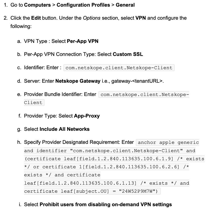

In the deployment guide I got from NetSkope a few weeks ago it talks about deploying a Per-App VPN client. I dont recall seeing this in earlier versions of the guide.
