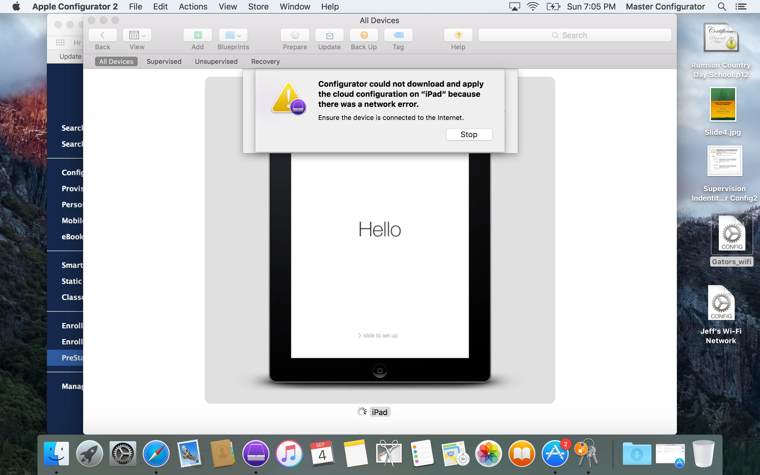

I can't seem to get past this error. Every time I try to prepare an iPad with Apple Configurator 2 blueprint, I get the attached error message. My wifi network is working, I have a working wifi profile installed on the blueprint, but preparation fails with the network error.

I've barely worked with Configurator 2 but in version 1, I ran into issues where I had to have the wifi network configuration profile labeled in a way alphabetically so that it applied first. Maybe give that a try.
For what it's worth I just recently started looking at Configurator 2 when I was configuring an Apple TV and it had trouble accessing jss so I did it in 2 steps where I only did wifi and then went back and did the rest. It worked when I did that so I'm assuming right now that the same problem exists. Maybe someone else will pipe in here with more knowledge or experience.
  • September 6, 2016
I used AC 2 all summer to enroll K4 iPads into DEP with a shared supervision identity.
My process was to first update iOS and install a local (created in AC2) wifi profile that would expire in 5 days
Then I would apply my DEP blueprint which includes a wifi profile downloaded from the JSS.
I I did not do step 1 with the wifi, and relied on the wifi in the blueprint,I frequently got that error.
I used two different profiles so that I would not get the "Do you want to replace...." question.
This was the most reliable method I came up with... 1427 iPads later
