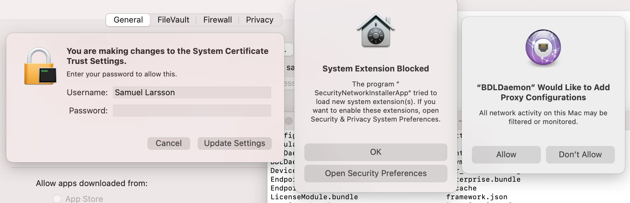

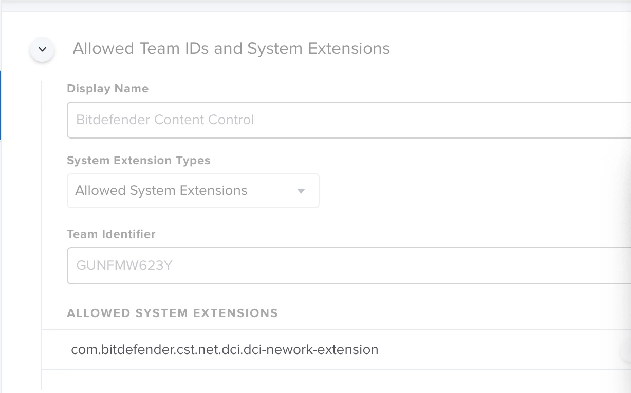

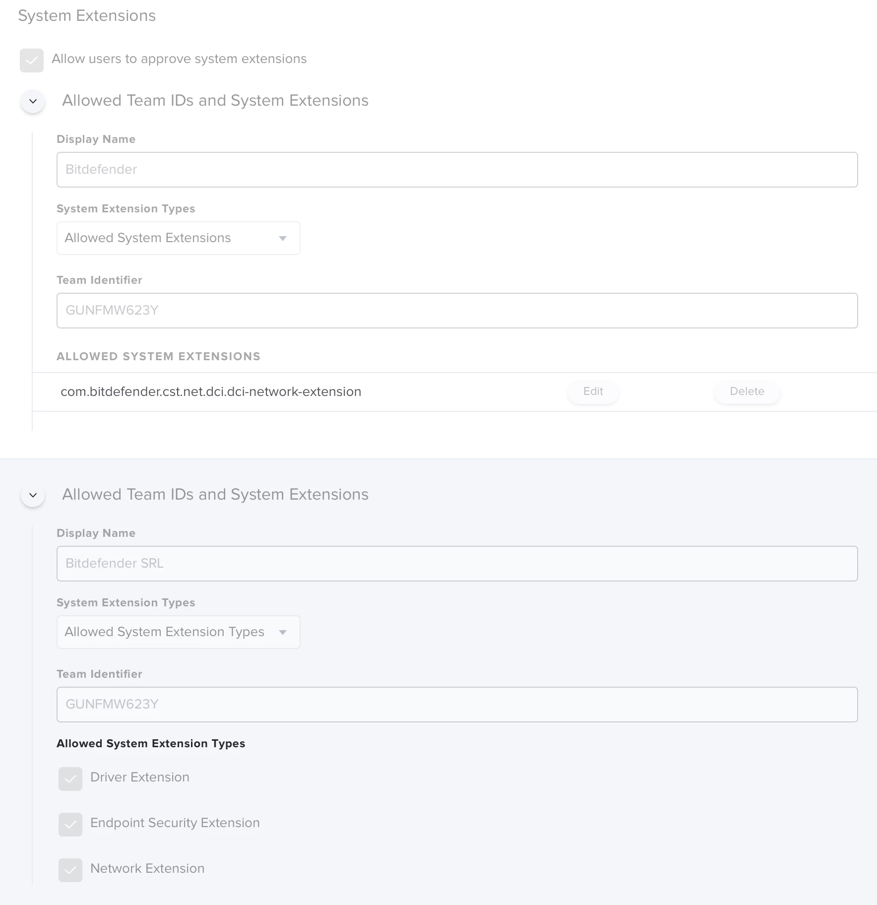

Hi,
Bitdefender has activated a new web content control module in the Endpoint Security app, which now results in the end user having to approve a system extension.
I have tried to add the below approved system extensions in a config profile, but they still show up. What else can I do?

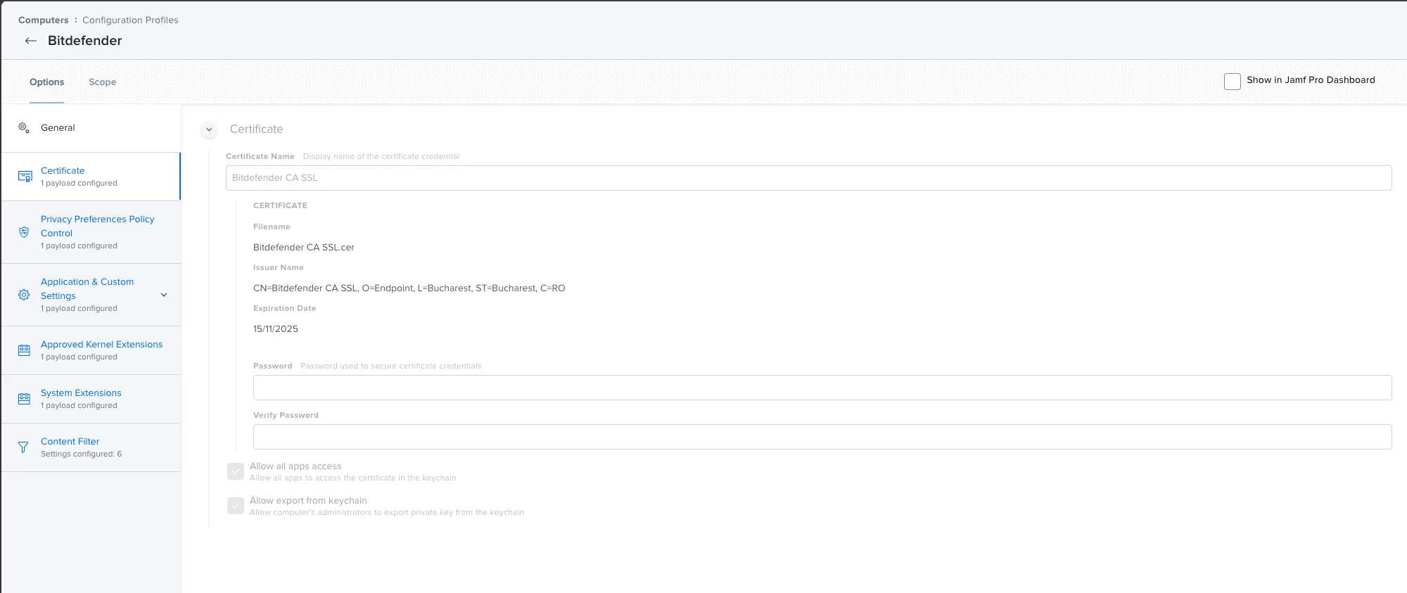

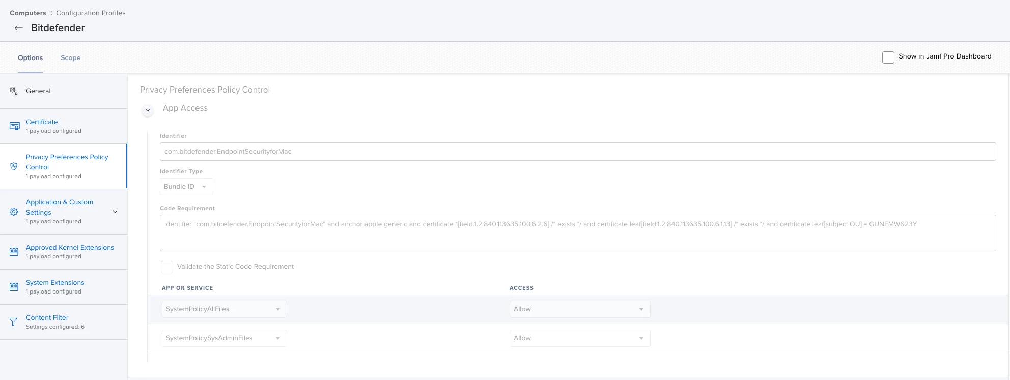

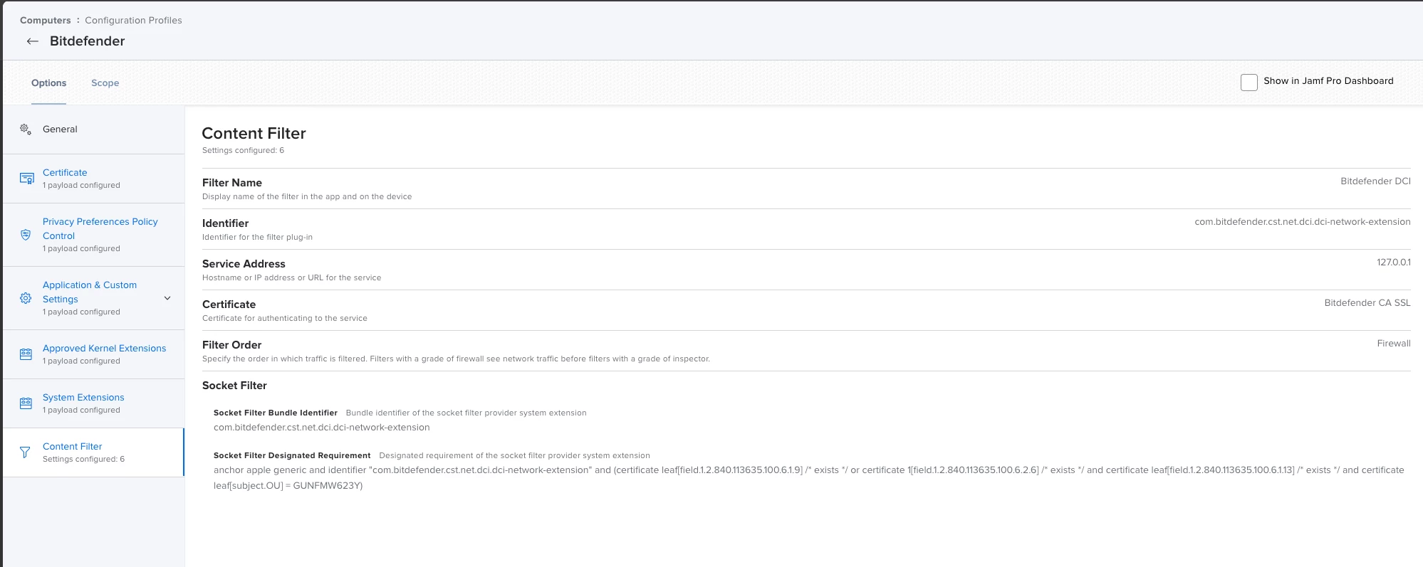

@samuellarsson I got hit by the same thing today after my clients for 4.15 update of Bitdefender, here is my configuration and early testing shows it is working for now.
Got info from this page https://www.bitdefender.com/support/changes-to-bitdefender-endpoint-security-for-mac-in-macos-big-sur-2626.html
export the SSL cert from one of you clients keychain as .cer and add it to your payload.
Hope this helps.

  • Feb 12, 2021 2:46 PM UTC
@greatkemo Thank you for your step-by-step tutorial.

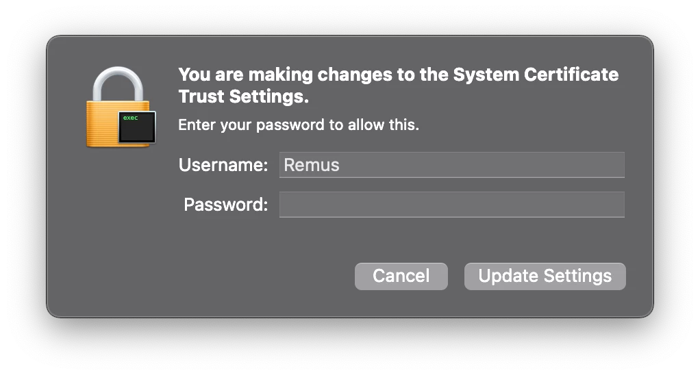

I managed to make it work but, is there a way to avoid having to type in the password for the certificate?
I exported the Bitdefender CA SSL certificate from my test machine and added it to JAMF. The certificate gets pushed from JAMF but then when Bitdefender starts, it ask for credentials to modify The System Certificate Trust……
  • Feb 12, 2021 2:51 PM UTC
@remus I am not seeing this issue, did you check the box for Allow all apps to use this certificate?

  • Feb 12, 2021 3:11 PM UTC
@greatkemo Ahaaaa! It is checked.
I'm testing on Big Sur 11.1. If you are not seeing the same behaviour then maybe there is bug in 11.1. (Wishful thinking, hehe)
I'll update to 11.2.1 and test again.
  • Feb 12, 2021 3:51 PM UTC
@remus and you selected your certificate in the Content Filter payload?
  • Feb 12, 2021 4:44 PM UTC
One thing I would also add, when I exported the cert from my laptop, it was already trusted, I did not have an issue with the trust. Not sure if that helps or not.

@greatkemo This is driving me nuts… Still not working! Every time I have to authenticate to make changes to the certificate.
When JAMF pushes the certificate it is "Always Trust"-ed in the keychain.
As soon as Bitdefender installs, it creates another certificate that needs to be authenticated.

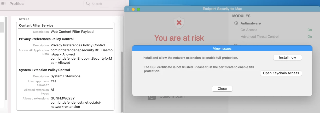

Experiencing the same issues and have also gone back and forth with Bitdefender support.
Currently, I'm at a point where I have configured a Configuration Profile using the instructions provided by Bitdefender.
https://www.bitdefender.com/support/bitdefender-endpoint-security-for-mac:-how-to-configure-jamf-pro-for-macos-big-sur-11-0-and-later-2661.html
However, this Configuration Profile is not allowing the System Extension, nor accepting the SSL Certificate (of course nothing in the Configuration Profile that would do so)
For now I am focusing on the System Extension, waiting back on Bitdefender support.

  • Feb 16, 2021 12:59 PM UTC
@remus I also got a lame response from them, which basically said that I was doing it wrong and that I should follow the steps in all the links which I already followed anyway.
I am sure the issue is this....
When you get prompted for a password to trust the certificate do this:
ps aux | grep add-trusted-cert | grep -v grep
You should see...
/usr/bin/security add-trusted-cert -d -r trustRoot -k /Library/Keychains/System.keychain /Library/Bitdefender/AVP/antivirus.bundle/rootCA.pem
So you can see that the app is trying to add their CA to the trust using the security command, which now in Big Sur requires users to authorize this transaction.
Instead, developers need to use Apple's API for certificates to add items to the keychain
https://developer.apple.com/documentation/security/certificate_key_and_trust_services/certificates
The annoying thing is, this is not new news a surprise from Apple, this was mentioned months ago.

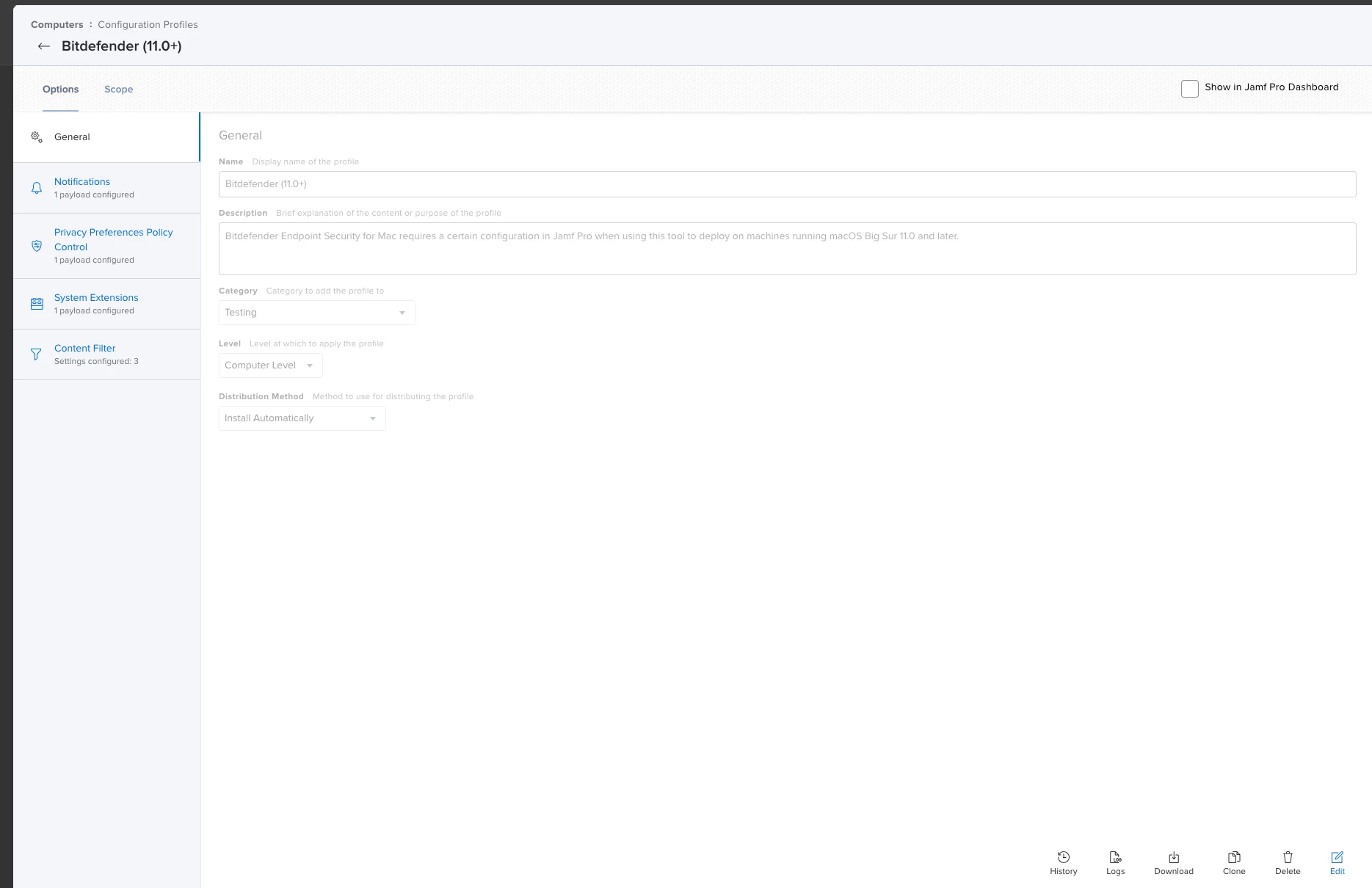

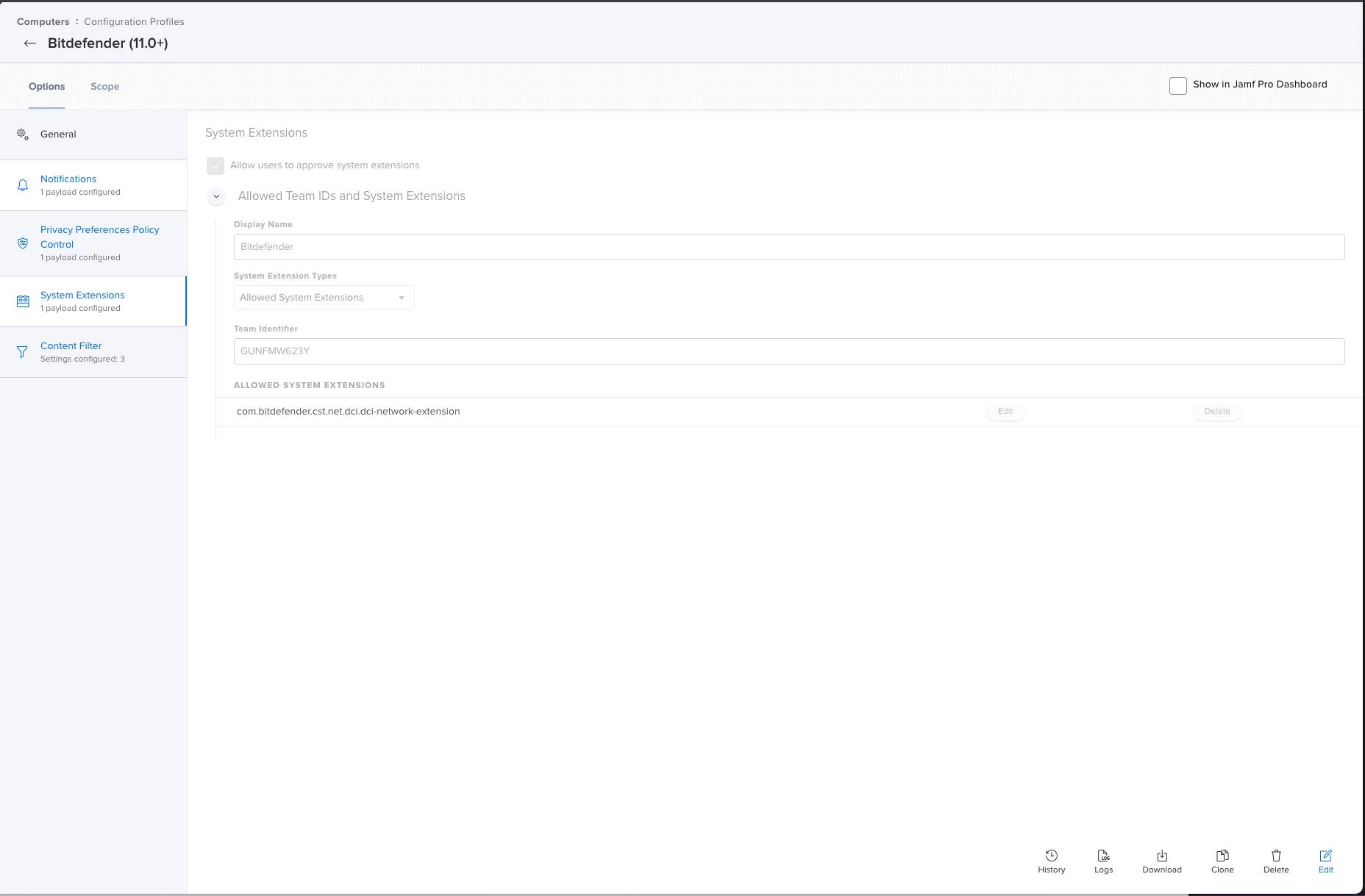

Here is what my Configuration Profile looks like

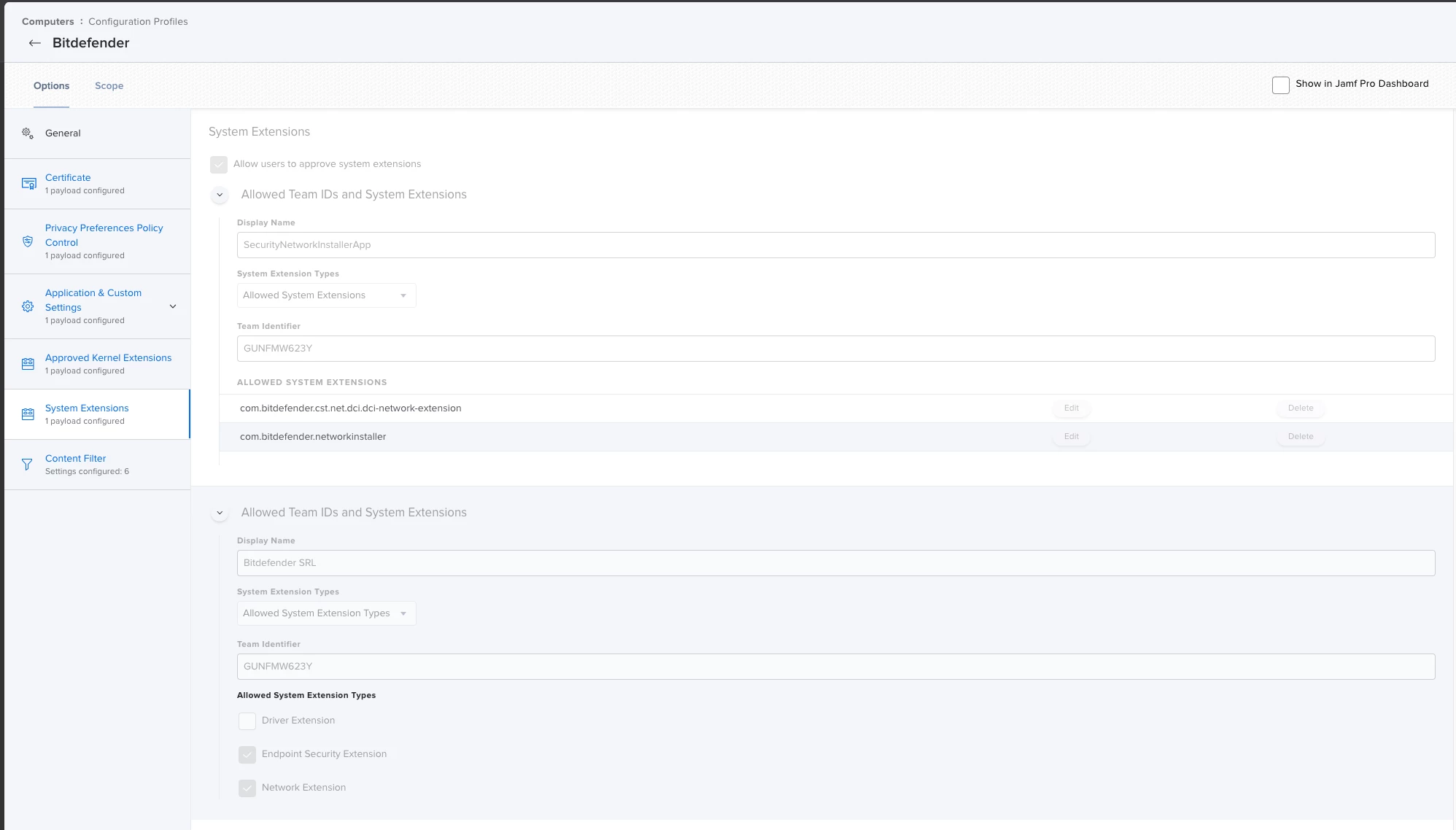

remus

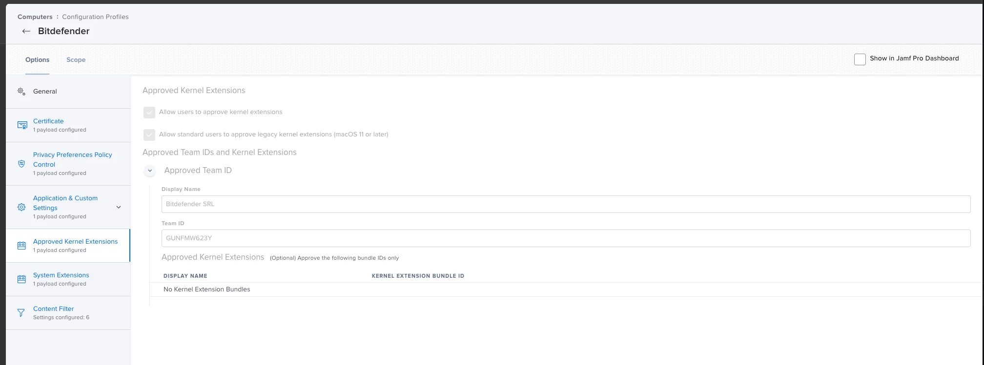

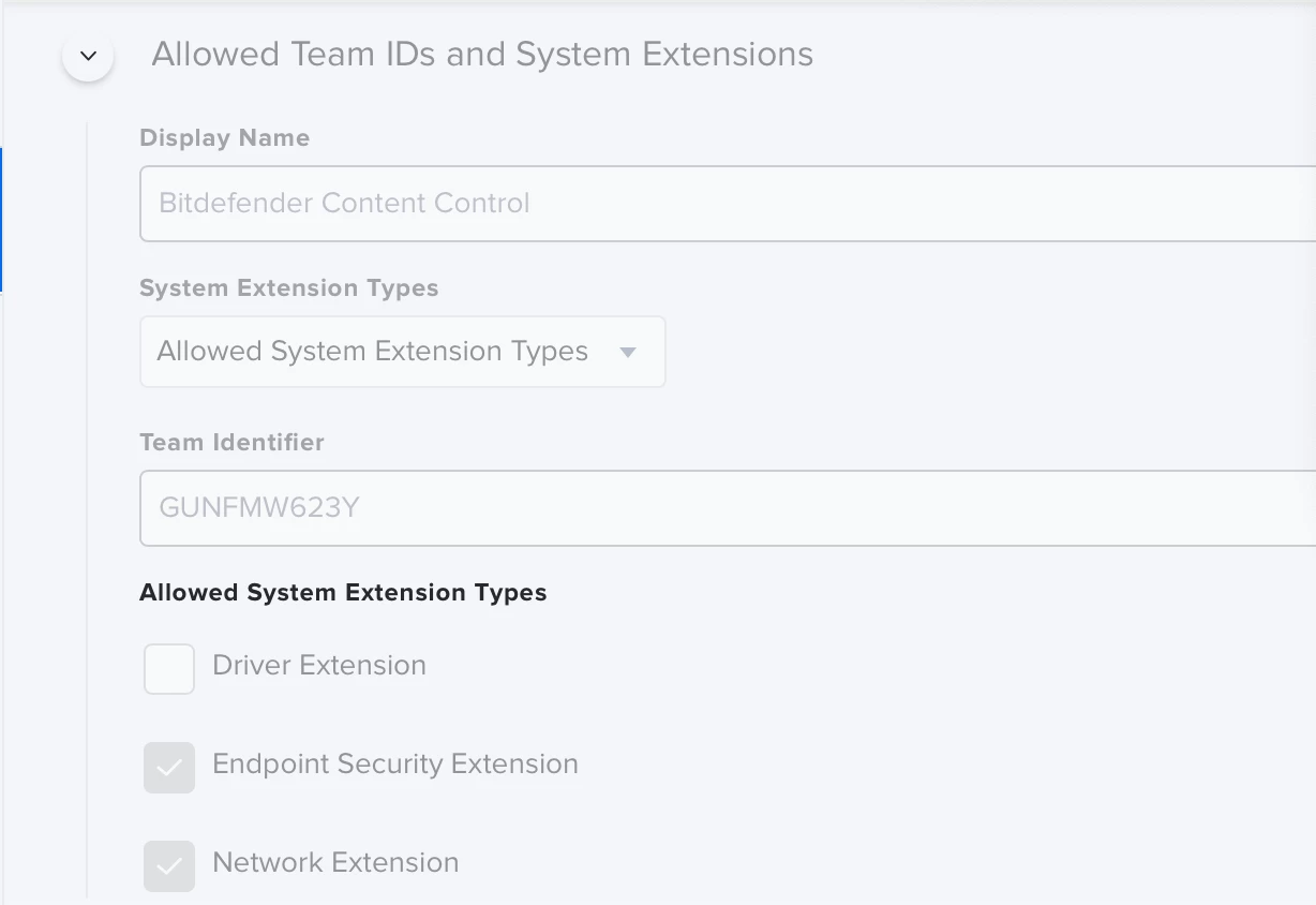

  • Feb 16, 2021 2:21 PM UTC
@cmasciarelli-L You probably did not checked Network Extension.
Use these screen-grabs as an example!
But you are going to hit a wall when it comes to the SSL Certificate.
In order to avoid that, disable the Content Control module and leave active only the Antimalware module.

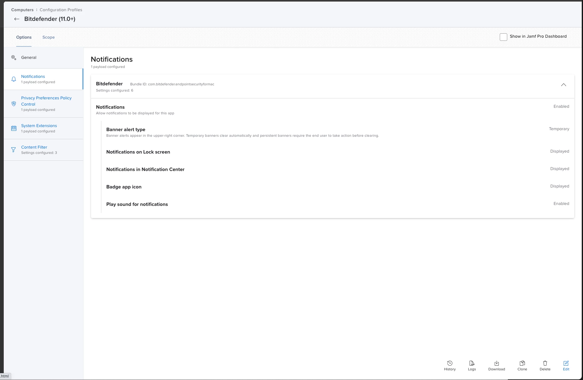

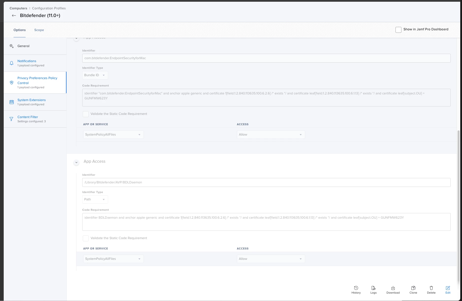

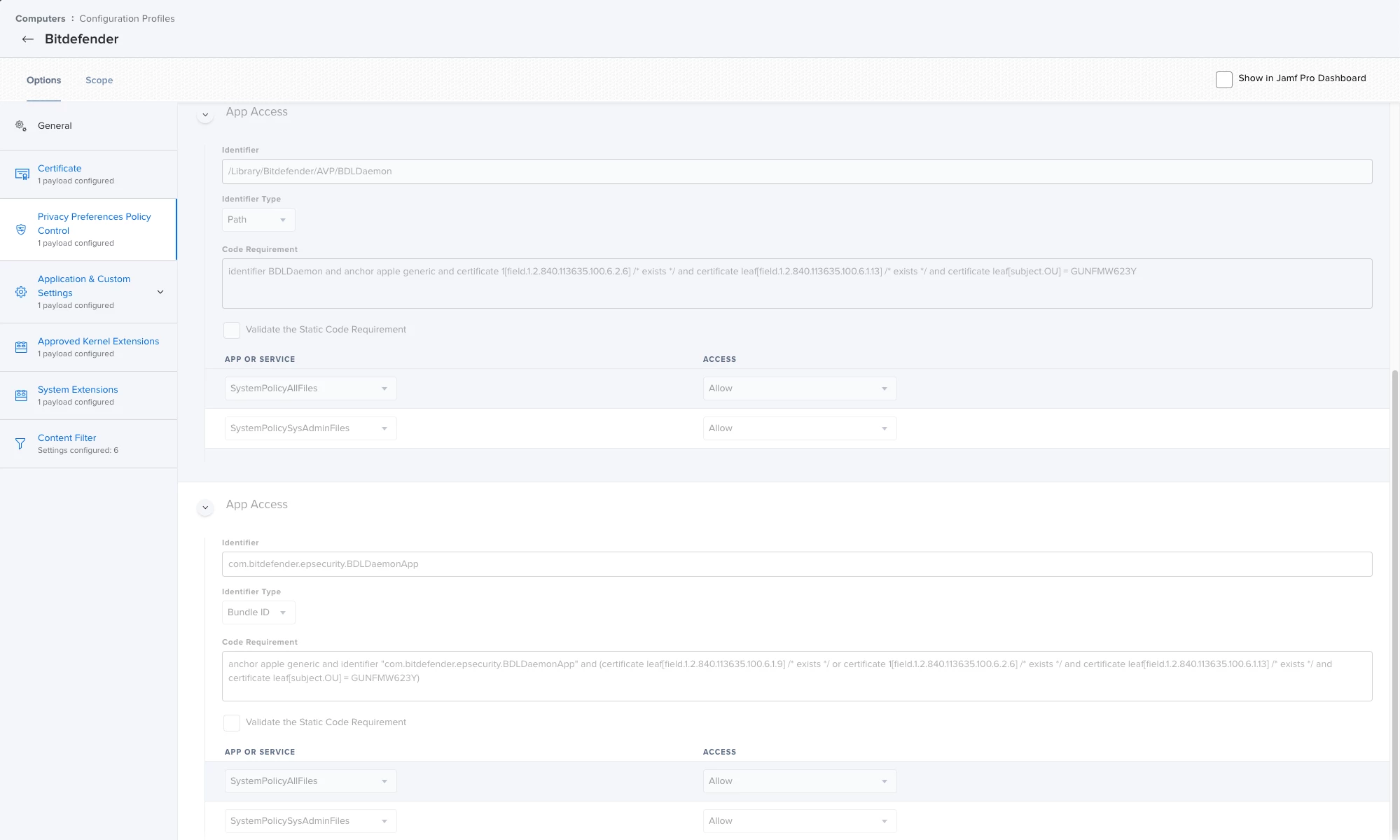

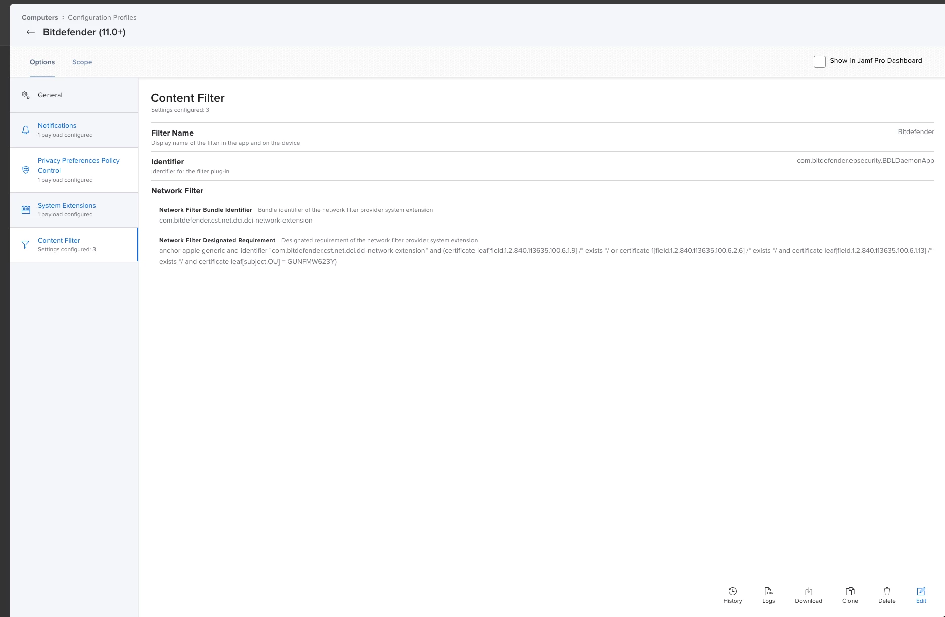

  • Feb 16, 2021 2:53 PM UTC

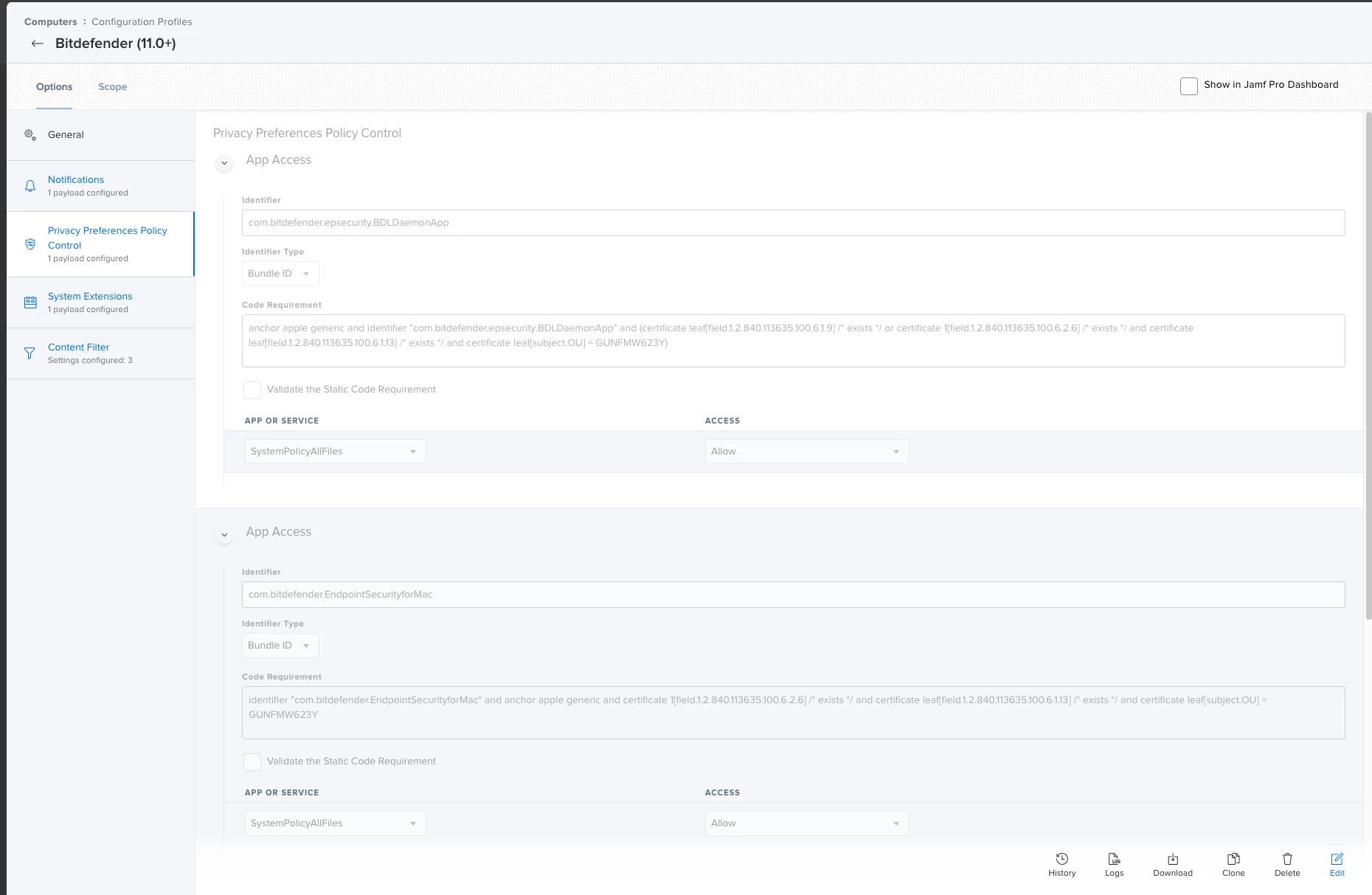

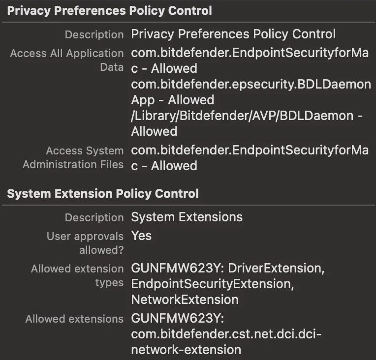

@remus @cmasciarelli-L
Use these, they are tidier and working (apart from cert of course), but don't forget these will work on Big Sur and Catalina if you have older clients then add Kernel Extension as well.
General
Notifications (Jamf Pro 10.27.0)
Bundle ID: com.bitdefender.endpointsecurityformac
Privacy Preference Policy Control
Identifier: com.bitdefender.EndpointSecurityforMac
Identifier Type: Bundle ID
Code Requirement: identifier "com.bitdefender.EndpointSecurityforMac" and anchor apple generic and certificate 1[field.1.2.840.113635.100.6.2.6] /* exists */ and certificate leaf[field.1.2.840.113635.100.6.1.13] /* exists */ and certificate leaf[subject.OU] = GUNFMW623Y
APP OR SERVICE: SystemPolicyAllFiles
ACCESS: Allow
Identifier: /Library/Bitdefender/AVP/BDLDaemon
Identifier Type: Path
Code Requirement: identifier BDLDaemon and anchor apple generic and certificate 1[field.1.2.840.113635.100.6.2.6] /* exists */ and certificate leaf[field.1.2.840.113635.100.6.1.13] /* exists */ and certificate leaf[subject.OU] = GUNFMW623Y
ACCESS: Allow
Identifier: com.bitdefender.epsecurity.BDLDaemonApp
Code Requirement: anchor apple generic and identifier "com.bitdefender.epsecurity.BDLDaemonApp" and (certificate leaf[field.1.2.840.113635.100.6.1.9] /* exists */ or certificate 1[field.1.2.840.113635.100.6.2.6] /* exists */ and certificate leaf[field.1.2.840.113635.100.6.1.13] /* exists */ and certificate leaf[subject.OU] = GUNFMW623Y)
ACCESS: Allow
System Extension
Display Name: Bitdefender
System Extension Types: Allowed System Extensions
Team Identifier: GUNFMW623Y
ALLOWED SYSTEM EXTENSIONS: com.bitdefender.cst.net.dci.dci-network-extension
Content Filter
Filter Name: Bitdefender
Network Filter Bundle Identifier: com.bitdefender.cst.net.dci.dci-network-extension
Network Filter Designated Requirement: anchor apple generic and identifier "com.bitdefender.cst.net.dci.dci-network-extension" and (certificate leaf[field.1.2.840.113635.100.6.1.9] /* exists */ or certificate 1[field.1.2.840.113635.100.6.2.6] /* exists */ and certificate leaf[field.1.2.840.113635.100.6.1.13] /* exists */ and certificate leaf[subject.OU] = GUNFMW623Y)
Hope this is helpful.

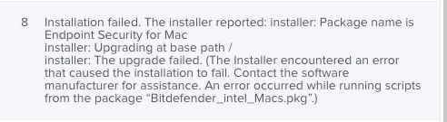

Anybody is having issues with installing the latest packages from Bitdefender using Jamf Pro? they have now a pkg for intel Macs and another one for M1 Macs.

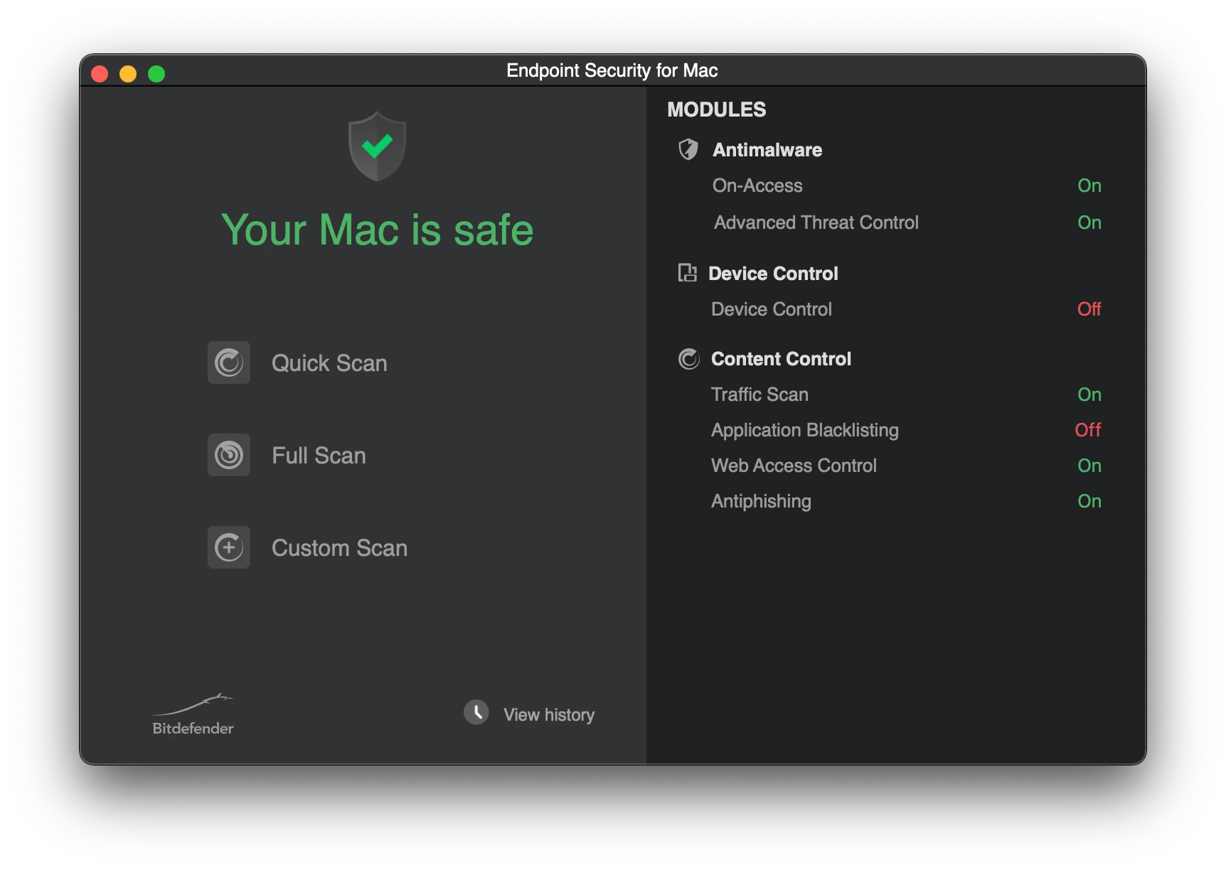

  • May 6, 2021 11:19 AM UTC
I've also hit this issue - Thankfully we don't actually make use of Content Control which got me wondering why the hell it was showing as a loaded module even though it's disabled!
I did a reconfigure on the client and it's now not showing the Content Control in the BEST main window.
I then created a new Package for Mac OS deployment without the CC module in there and noticed that the download URL differed from the original one I was using.
I've now updated the installer script in Jamf Pro to use that installer and hope it removes this prompt :)
I know it's not ideal if you do use CC but may provide some help for those who don't use it.
