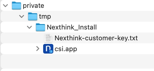

mm2270
  • Jun 8, 2023 6:15 PM UTC
But why cant I make it packaged after placing the .dmg into /tmp?
@Asifahmed I'm not sure I understand your question. It DOES need to be packaged and deployed, but the reality is the only item from the DMG you need to push is the csi.app. The other items are GUI installers/uninstallers and can't be run through an automation script as they weren't designed for that.
Here's what my Nexthink package looks like in Composer.
I'm only pushing the csi.app and the customer key into a folder in /private/tmp/ From there, a post install script (in the Jamf policy, not in the package) runs and references the path to the csi.app and executes it with the necessary flags and settings to do the installation.
