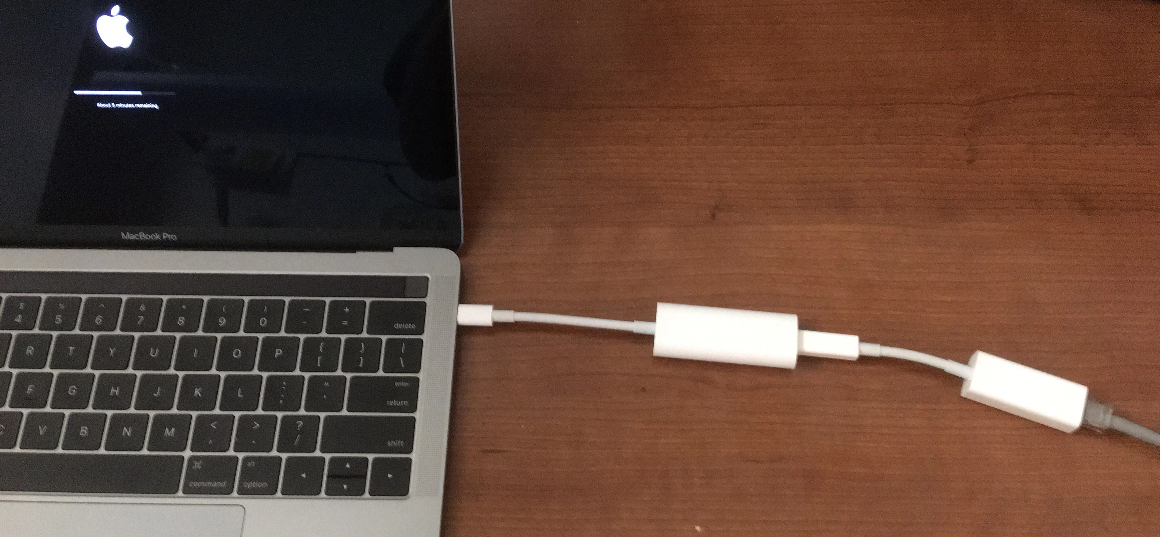

  • Apr 29, 2019 8:59 PM UTC
SOLUTION: I found this on discussions.apple.com. Here's a paste from the original post to give proper credit:
"Thunderbolt 3 (USB-C) to Thunderbolt 2 + Thunderbolt to Gigabit Ethernet Adapters(Both made by Apple)
With this combination of connecting Ethernet over two adapters to one of your USB-C port everything works like charm. Internet Recovery boots fast and installation is stable.
On the other hand it's pretty weird that Apple sells something officially on Apple Store (I'm talking about Belkin USB-C to Gigabit Ethernet Adapter) which doesn't really work for Apple's Key Services what Internet Recovery certainly is!
Thunderbolt to Gigabit Ethernet Adapter by Apple have Vendor Name: Apple Inc., Vendor ID: 0x1 and Product ID: 0x8003 instead of Realtek Semiconductor used in Belkin's Adapter which probably makes difference. It seems like Realtek ethernet chipset is the thing which is causing the problems.
I think that Apple should take care of this it self and at least provide it's own USB-C to Ethernet Adapter which works properly, when they left us just with 4 USB-C ports and nothing else on these days MacBooks. This adapter to adapter to adapter ... chains is not really a fancy solution.
Have great day everyone, bye".

  • Mar 11, 2024 5:26 PM UTC
I think @bradtchapman hit the nail on the head. A Thunderbolt 3-to-Ethernet adapter would almost certainly work, if only one existed. So far as I can tell, no such device exists.  (Well, there are Thunderbolt Ethernet adapters for 10GB ethernet, but those are typically $200 or more.)
(If you search Amazon or eBay, you'll see lots of listings for Thunderbolt Ethernet adapters, but careful reading shows that every single one is really just a USB device, and they're using "Thunderbolt" to mean "USB-C.")
So I think the best solution is still the combination of the Apple Thunderbolt to Gigabit Ethernet Adapter (which has a Thunderbolt 2 port) with the Apple Thunderbolt 3 (USB-C) to Thunderbolt 2 Adapter as pictured by @rsterner above.
The latter is available from Apple (the above link goes to Apple's online store).  The former is discontinued, but readily available (used, usually) from both Amazon and eBay.

Yep,  The double dongle is the only realistic option for these Intel Macs.
Internet Recovery is very convenient as a restore of last resort, but I'm glad we don't have to do this anymore on Apple Silicon Macs.
