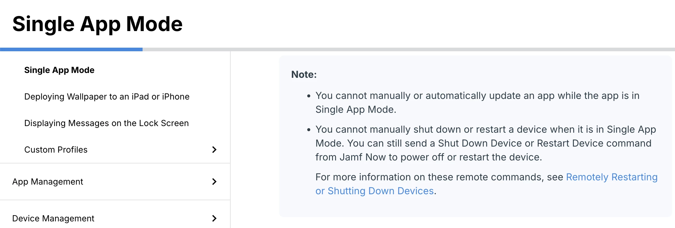

I have read that iPads wont do automatic updates as long as they are in Single App mode. Can someone confirm this? We will hold test at university with those and it would be really bad, if an iPad started an OS Update during the test by some mistake. But if that is true it would not be an issue, as they are all in SAM.
Best answer by agungsujiwo
@Andixon
Here is the documentation from Jamf > Single App Mode,
surely after seeing this you will be calm,

Shyamsundar
  • Nov 14, 2024 10:22 AM UTC
your right, it won't update automatically when they are in Single App mode.

agungsujiwo
  • Nov 15, 2024 1:07 AM UTC
@Andixon
