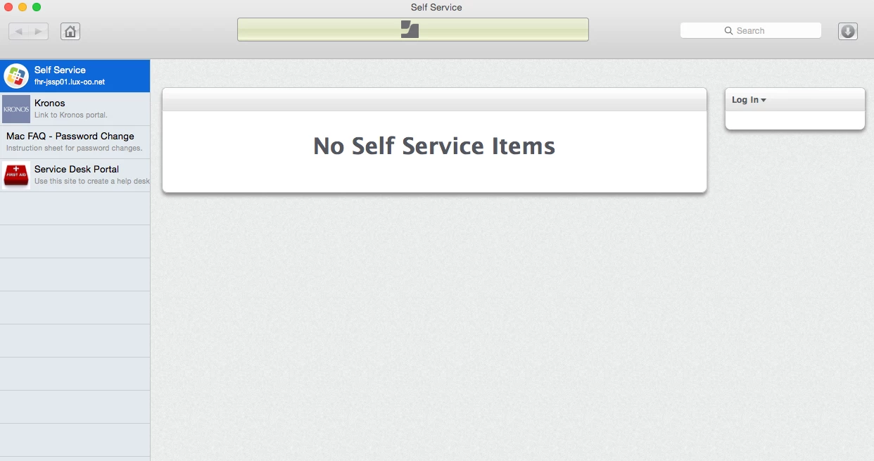

Hello,
All of the sudden we are seeing a lot of our Macs getting the error message of: No Self Service Items are available
No Authorization
I saw a prior post that mentioned checking the selfservice cache location, along with Safari cookie settings. I checked and cleared those areas on my Mac, but am still getting that error. We are still running JSS v9.6, but this just started up today. Our Self Service is configured to allow authentication, but not require it.
I've tried rebooting our JSS, but still am getting that error message.
Any thoughts on this?
Tim
Best answer by musat
I know this is old, but we just had another with this message, so I figured I would post what the issue actually was. I didn't know this, but it turns out that if cookies are blocked in Safari (maybe the default browser) this error message displays.
