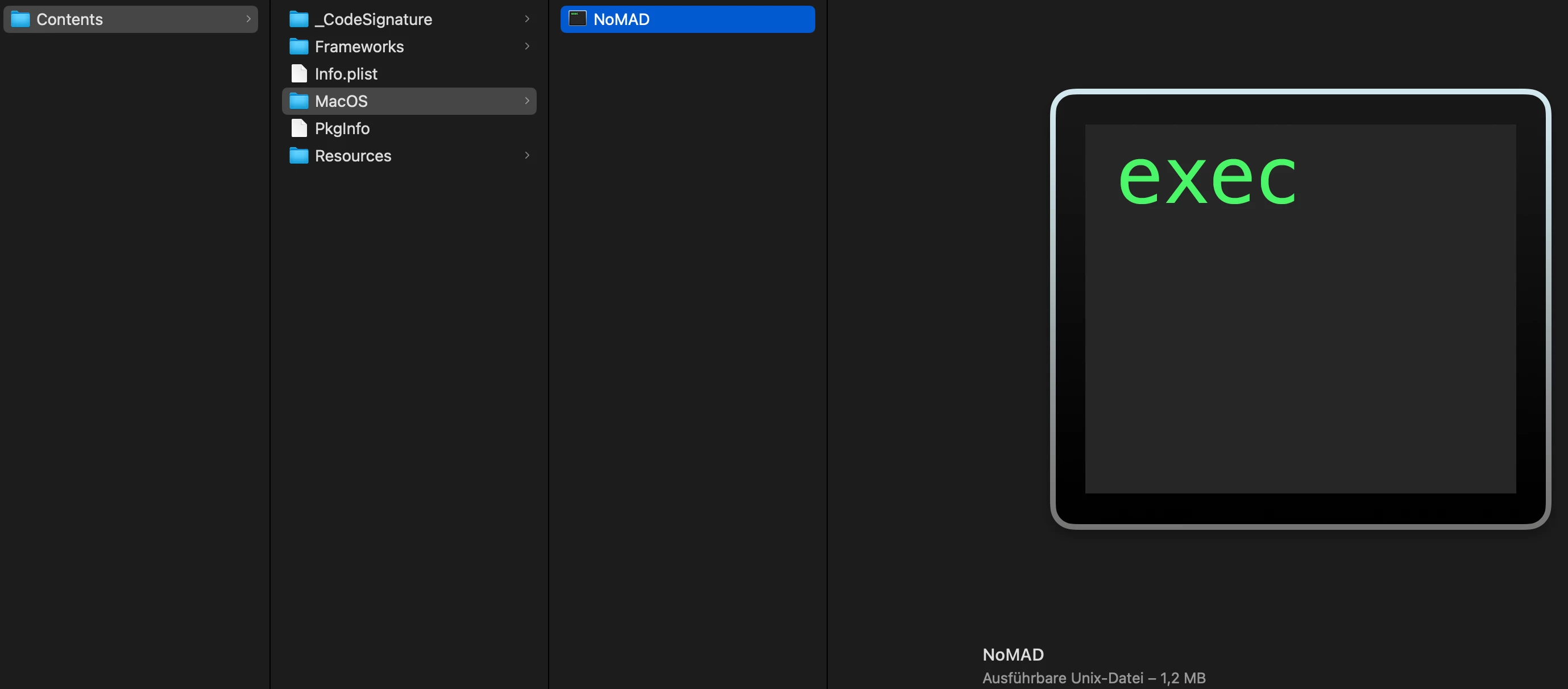

Nobody can change their AD password via NoMAD. This error shows up:
"Unable to change password: Configuration file does not specify default realm"
I found out as soon as I go to the nomad app container and execute the unix file, another NoMAD instance is opening and showing an icon in the menu bar, where I can successfully change my AD password:

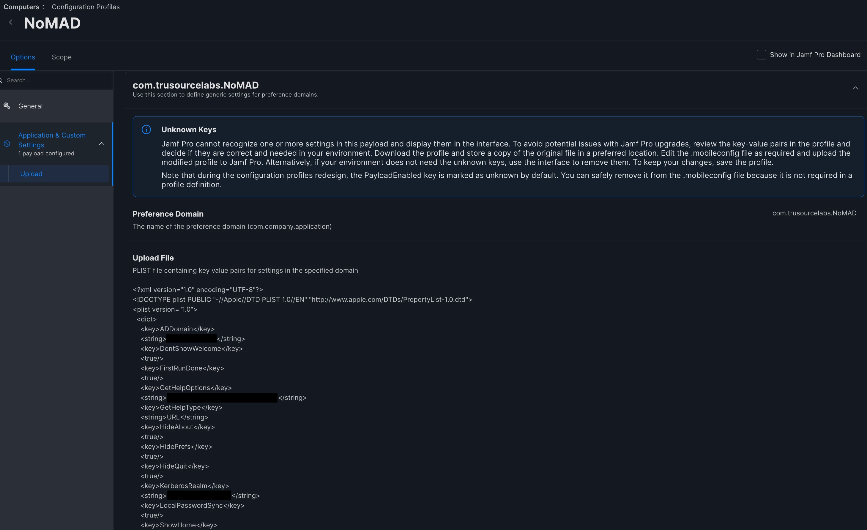

In Jamf we deliver nomad and the launch agent as a policy and a Plist as a configuration profile.
This comes from the past, I dont know if this is enough and correct in this time:
The weird thing is that it is working with the unix file inside the nomad.app which is on all our Macs.

I still have to use Nomad (hoping to move off soon) but I know that when I set it up initially, I had a similar issue and the fix for me was just putting my kerberos realm in all Caps like DOMAIN.COM
  • Oct 24, 2024 2:45 PM UTC
I also read this and our Kerberos realm is EXAMPLE.LOCAL (same like AD Domain just in Capslock).
jamiesmithJAX
This is the configuration I have been using for years, only occasionally editing the password policy rules that display when you click the ? when changing your password.  I have had no issues with it
<?xml version="1.0" encoding="UTF-8"?> <!DOCTYPE plist PUBLIC "-//Apple//DTD PLIST 1.0//EN" "http://www.apple.com/DTDs/PropertyList-1.0.dtd"> <plist version="1.0"> <dict> <key>ADDomain</key> <string>DOMAIN.COM</string> <key>GetHelpOptions</key> <string>mailto:helpdesk@domain.com</string> <key>GetHelpType</key> <string>URL</string> <key>HideExpiration</key> <false/> <key>HidePrefs</key> <True/> <key>KerberosRealm</key> <string>JAX.ORG</string> <key>KeychainItems</key> <dict> <key>Exchange</key> <string>&lt;&lt;shortname&gt;&gt;@company.org</string> </dict> <key>LocalPasswordSync</key> <true/> <key>MenuAbout</key> <string>About NoMAD</string> <key>MenuGetHelp</key> <string>Contact the Service Desk</string> <key>MenuGetSoftware</key> <string>Self Service</string> <key>MenuHomeDirectory</key> <string>Network home folder</string> <key>MenuRenewTickets</key> <string>Renew Kerberos Tickets</string> <key>PasswordPolicy</key> <dict> <key>minLength</key> <string>16</string> <key>minLowerCase</key> <string>1</string> <key>minMatches</key> <string>3</string> <key>minNumber</key> <string>1</string> <key>minSymbol</key> <string>1</string> <key>minUpperCase</key> <string>1</string> </dict> <key>MessagePasswordChangePolicy</key> <string>PassPhrase Complexity Requirements • Minimum of 16 characters • Consider a passphrase that is long, complex, hard to crack but easy for you to remember. A phrase, such as a song lyric, book title, or quote will be longer in length, easy for you to remember, and difficult for someone else to guess. Example: Smelltheroses!10 • Include at least one character from at least three of the following five categories: 1. Uppercase (A-Z) 2. Lowercase (a-z) 3. Base 10 digits (0-9) 4. Non-alphanumeric characters (like !@#$%^) 5. Any Unicode character including Unicode characters from Asian languages. </string> <key>MessageUPCAlert</key> <string>Your password was changed elsewhere.</string> <key>PasswordExpireCustomAlertTime</key> <integer>0</integer> <key>RenewTickets</key> <true/> <key>DontShowWelcome</key> <true/> <key>HideRenew</key> <true/> <key>HidePrefs</key> <true/> <key>SecondsToRenew</key> <string>7200</string> <key>ShowHome</key> <true/> <key>UPCAlert</key> <true/> <key>UseKeychain</key> <true/> </dict> </plist>
