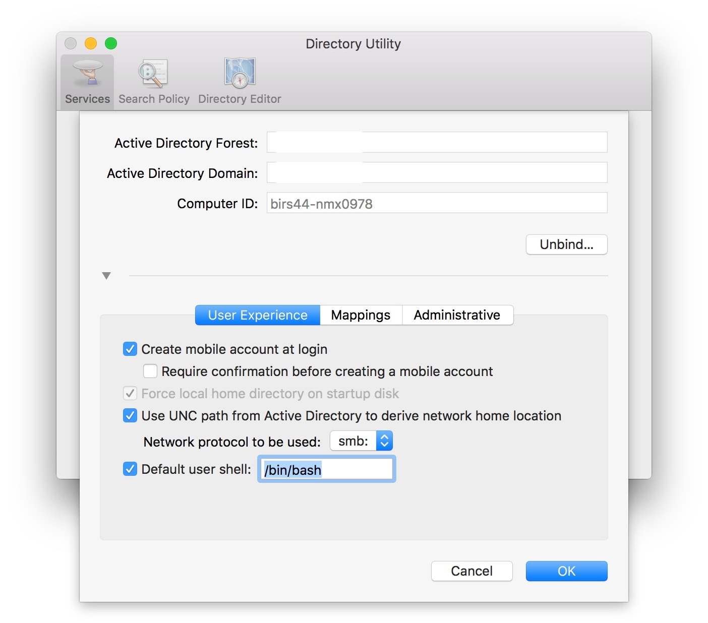

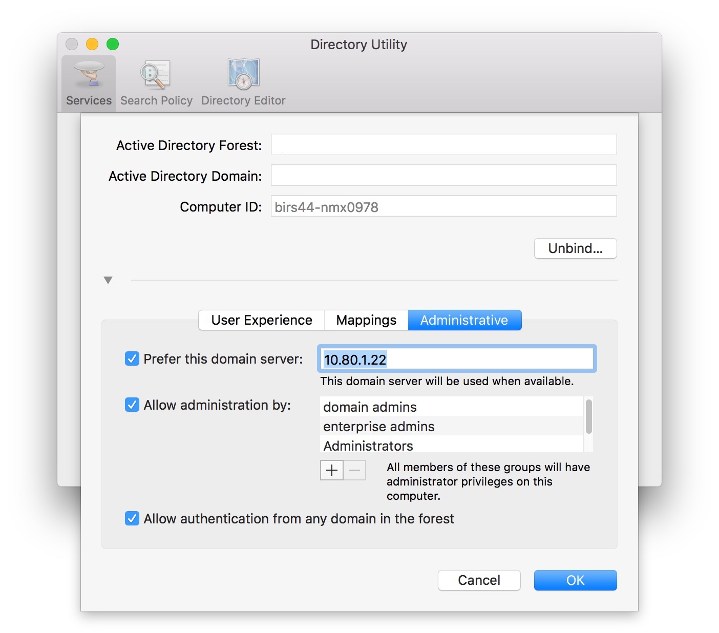

  • A script to bind machines to Active Directory. The script will be cloned and scoped respective to their site designation.
  • The script needs to enable me to set the following variables:
  • Create mobile account at login
  • Specify a preferred domain serve (via IP address)
  • Allow administration by- groupA, userB
  • Allow authentication from any domain in the forest
  • Use UNC path from Active Directory to derive network from home location
  • Network protocol to be used: smb
  • Default user shell: /bin/bash

The JSS has a section under "Computer Management" where you can configure Directory Bindings with a very user-friendly GUI tool that will do everything you want it to do.
Then run your Directory Binding at imaging or as a post-enroll policy.
bpavlov
  • October 17, 2016
JSS -> Settings Gear -> Click on the Directory Binding button under Computer Management
Create a new directory binding and fill out the information accordingly.
To actually use the directory binding you've just created, you can do so in 3 ways:
1. Casper Imaging > Create new configuration and choose whether to use a directory binding
2. Computers > Policy > Create a new policy and choose a directory binding to apply
3. Computers > Configuration Profile > Create a new configuration profile and pick a directory binding.
I personally like option 2 the best because it gives you flexibility. Option 3 with the configuration profile I do not trust simply because if the configuration profile gets dropped then you lose the binding. Also, if you need to do troubleshooting you then need to worry about getting rid of the profile on the computer. It adds extra layers of complexity.

man dsconfigad
should be quite helpful.
for the administrators part, I usually do a
/usr/sbin/dseditgroup -o edit -n . -a "$1"@domain.com admin
If you don't want to write it yourself, here's what I got:

  • October 26, 2016
@teodle Apologies for the late reply. Here is an copy of the naming script we are using. We just clone it and change the yourCompanyPrefix to be relevant to site we are scoping the script to. Curtesy of @gavin.pardoe for putting it together for us.
!/bin/bash
Machine Naming Script Oct 2016 - BIRMINGHAM ONLY
Will Set Machine Name Based on Location, Device Model & Last 6 Digits of Serial Number
Get Device Model
deviceType=$(system_profiler SPHardwareDataType | awk -F'"' '/Model Name/{print $0}' | awk '{ print $3 }')
if [[ $deviceType == MacBook ]]; then echo device=NX-
else echo device=DX-
Get Last 6 Digits of Serial Number
serialNum=$(ioreg -c IOPlatformExpertDevice -d 2 | awk -F" '/IOPlatformSerialNumber/{print $(NF-1)}' | rev | cut -c 1-6 | rev)
Set Machine Name
/usr/sbin/scutil --set ComputerName yourCompanyPrefix$device$serialNum
/usr/sbin/scutil --set LocalHostName yourCompanyPrefix$device$serialNum
