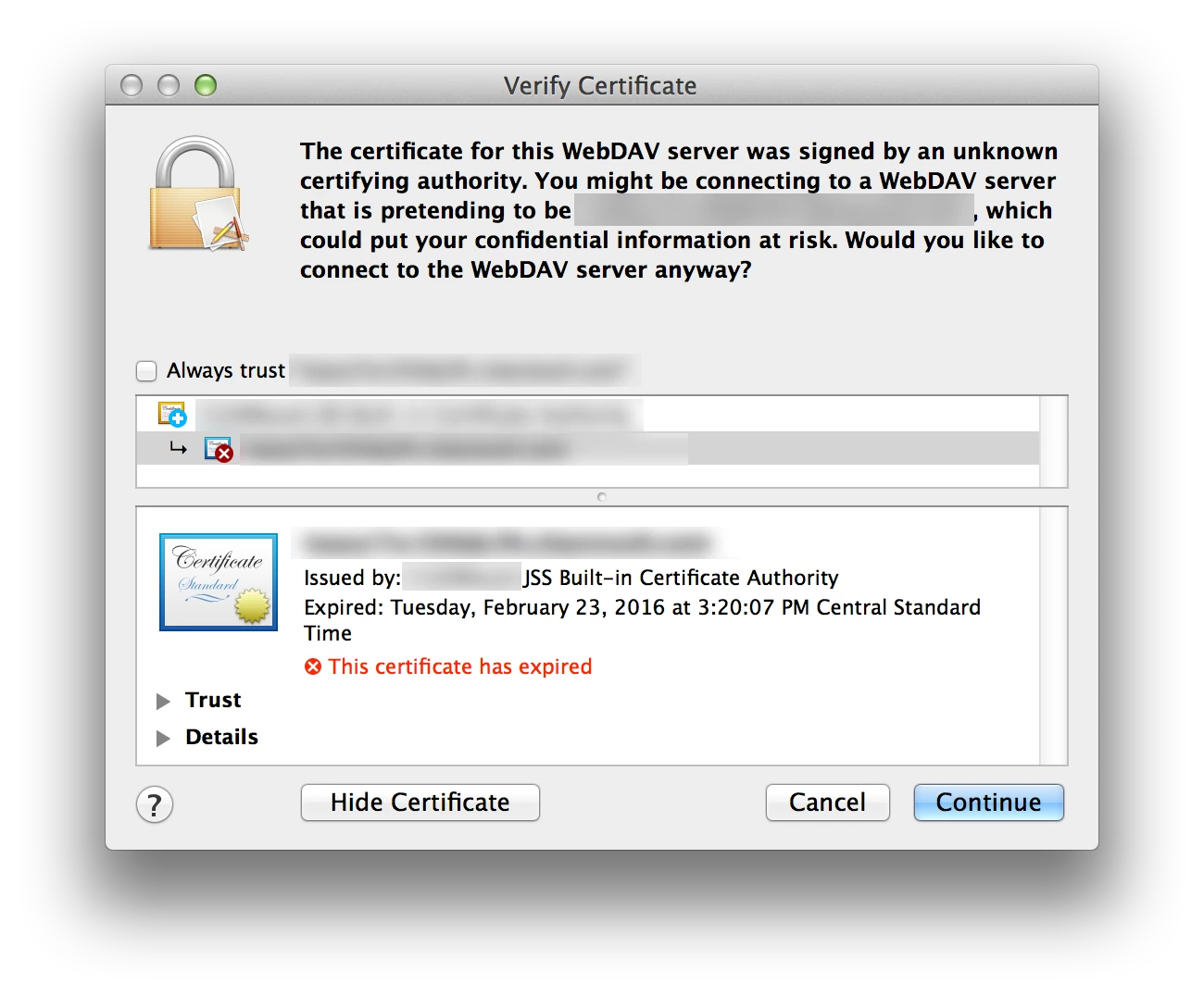

I've also noticed that now when i open Casper Admin it gives me a certificate error, showing that the cert has expired, i'm assuming the download issue could be related to this ?
Checking on the JSS the Tomcat cert is definitely valid, i know we installed it in December.
If i view the certificate by right clicking on the JSS URL in Safari it also shows the same valid certificate.
I'm not sure where this old certificate is being picked up from ? i've spoken to the network team and been assured that nothing has changed...
This is the message when opening Casper Admin
