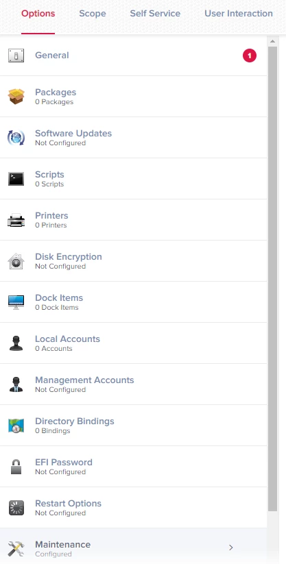

Ok, great. The main extension you would want would be the  application protect status one. jamfprotect/jamf_protect_application_status.sh at main ยท jamf/jamfprotect (github.com)
The states will populate on the next inventory cycle the workstation runs. Your only other way to get the state information would be to run terminal commands on the machine. For future, the terminal command line to get the state is sudo protectctl info. Rather than trying to walk your users through the terminal commands you could try this potential alternative option to force an inventory cycle. This assumes that the JAMF Pro Binary is healthy.
Create a new policy, set an update inventory maintenance task, make it available in self service for users to run. This will enable you to get the inventory information updated to troubleshoot as a once off.
As a side thought as well, for ongoing maintenance it would be worth configuring a policy to inventory update with a recurring check in to execute once every week. This will give you regular updates for your inventory.
