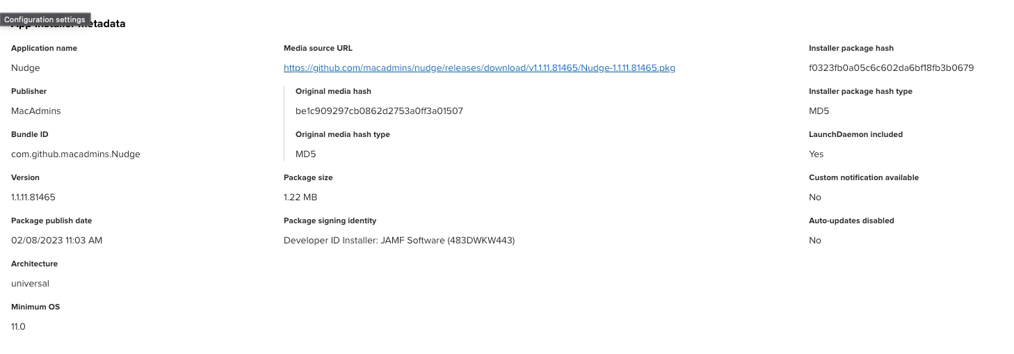

I am setting up Nudge to be deployed via the Jamf App Catalog to facilitate keeping it up to date, but it does not appear to be installing the LaunchAgent even though the listing says it will
1) is this (or should it even be) the intended behavior?
2) Who manages the Jamf App Catalog entries?
Honestly, I think having a separate Nudge Launch Agent in the App Catalog may be better (in order to Balance the ease of Auto-Updates and deployments vs managing the Agent separately if that is also wanted)

@Alex_Renna the 'LaunchDaemon included' tag in your screenshot refers to the App Installers LaunchDaemon, not any Launch Daemons / Launch Agents that the original software title may include. Most App Installers titles have a bundled LaunchDaemon that actually queues up the installation and then performs the installation on the End User computer if/when the app is not in use.
  • Feb 24, 2023 2:48 PM UTC
Thanks for the clarification. If an apps do not include a LaunchDaemon, does that mean the update is instant, or needs to be done manually?
JustinC
  • Employee
  • Feb 28, 2023 2:11 AM UTC
@Alex_Renna the titles that do not have the App Installers LaunchDaemon are 'background' apps that we can quit, update and relaunch without affecting the user. Examples of these include titles such as Dropbox and OneDrive.
