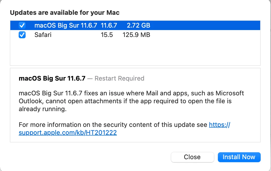

Correct me if I am wrong but Jamf does not have any way of enforcing software updates anymore correct? For example on my specific Test mac I have a couple available updates. An update to 11.6.7 and then a Safari update.
From what I heard Jamf cannot enforce a user to install these, I was recommended to use Nudge but from my understanding Nudge is designed to take care of the security updates and macOS minor and major updates but does not tackle other updates like in my case, safari? I know nudge doesn't really auto enforce these besides gently nudging all the way to annoyingly nudge the user but will it also look and nudge based off other software updates like Safari?

I've only played with it a little, but my understanding of Nudge was that it would prompt to install any updates from Apple that show up in the Software Update preference pane. So, yes, unless I'm mistaken, it should "nudge" to install a Safari update as well.
