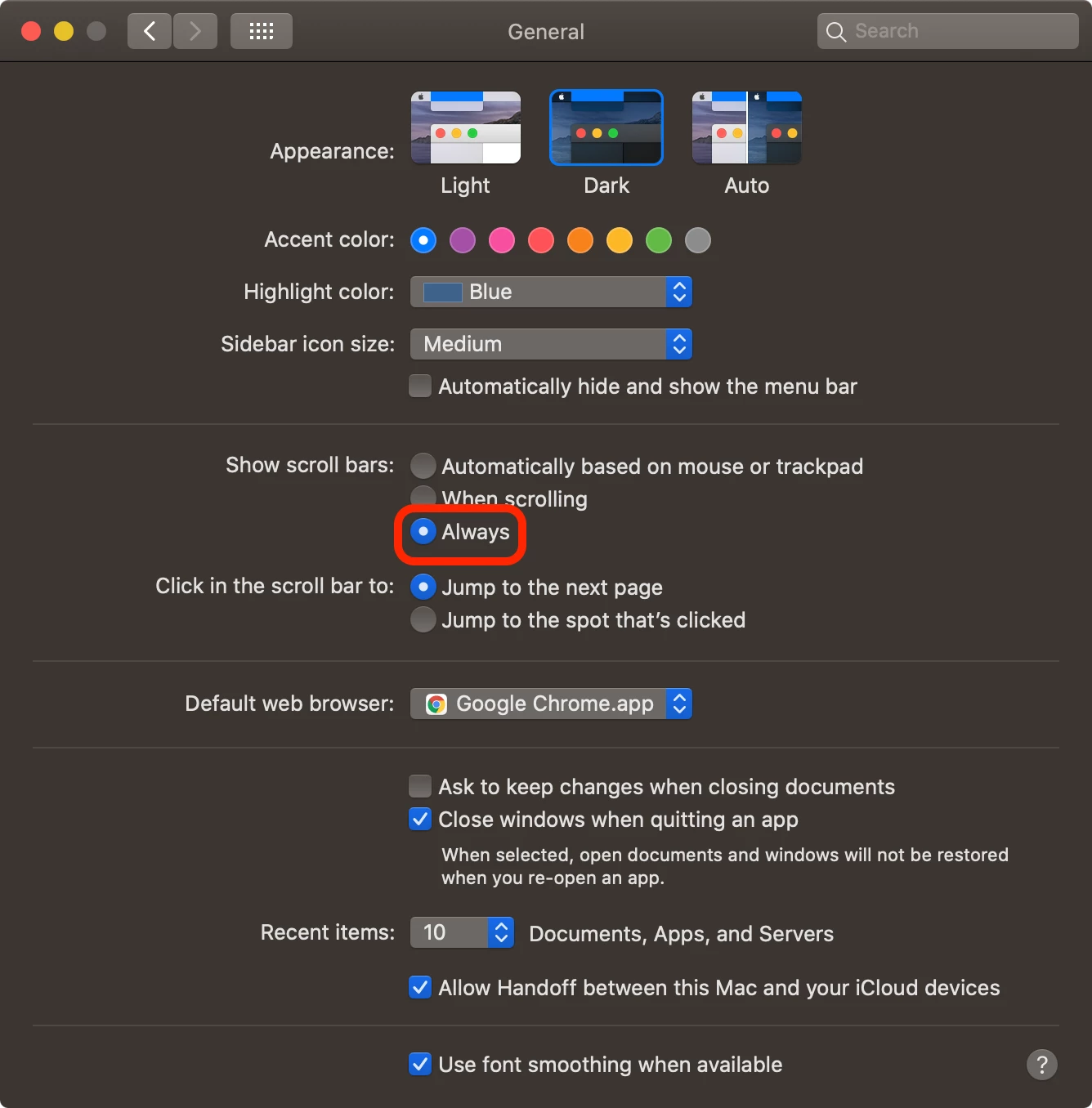

I was able to replicate this issue just now. If you have enough categories visible to warrant the need for the scrollbars, and scrollbar visibility is enabled, the categories disappear.
Setting it to 'when scrolling' with an old school mouse connected fixes it.
Trackpads on MacBooks usually hide the scrollbars, so that would explain why I haven't seen it on any of my laptops.
Looks like the view isn't accounting for the extra space imposed by having visible scrollbars.

Awesome work all! I can confirm this behavior as well when set to 'Always' vs when set to any other value.
