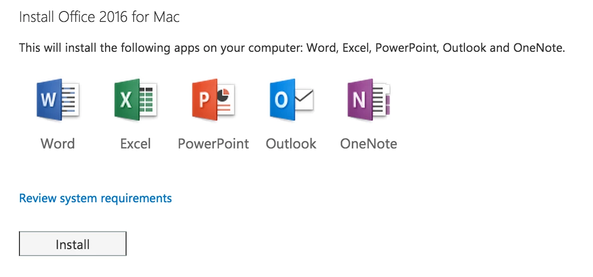

I've created a DMG from Composer and tested this as an upgrade from 15.12.3 to 15.13.1 but getting the following errors (see below). This problem also surfaces if the Office Suite is installed using the unaltered PKG directly from Office 365.

@bpavlov Yup! Same process that I follow for all other installations/package creations. I received the PKG directly from my Office 365 Settings page (https://portal.office.com/OLS/MySoftware.aspx). Here are the steps I took following this.
  1. I rolled back my VMWare Fusion v7.1.2 Virtual Machine to my base OS X 10.10.4.
  2. Opened Composter and took a snapshot.
  3. Copied the PKG from my native OS and over to the VM.
  4. Performed the installation from the PKG.
  5. Completed the snapshot and generated a DNG file.
  6. Opened Casper Admin and uploaded the DNG file.
  7. Indexed then saved the changes made in Casper Admin.

@bpavlov Office 2016 is currently deployed as v15.12.3 and users are prompted to upgraded. When using the Auto Installer from Microsoft, the error is not present. Given that the DMG is more efficient with deployments, we've typically used them for Office deployments. The strange issue here is that the same error is produced regardless of which file extension is used. I suspect something is wrong with the Office 365 installer extracted from the page mentioned above (https://portal.office.com/OLS/MySoftware.aspx).
