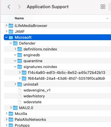

One thing I just came across - In our environment we use Microsoft Defender ATP. When I run the Complete Removal Package it deletes this entire directory when it removes MAU: "/Library/Application Support/Microsoft" which in my case, also contains a "Defender" folder. It appears this Defender folder is where quarantine, signatures, definitions, etc. are stored. Is there a way you can modify your 'Complete Removal Package' so it just removes the "MAU2.0" directory and not the parent "Microsoft" Directory along with it?
EDIT Sorry I may have been a bit trigger happy on my post - After a restart this entire Defender folder reappeared...so modifying your tool may not be necessary. Interesting to know anyways. Thanks again!
