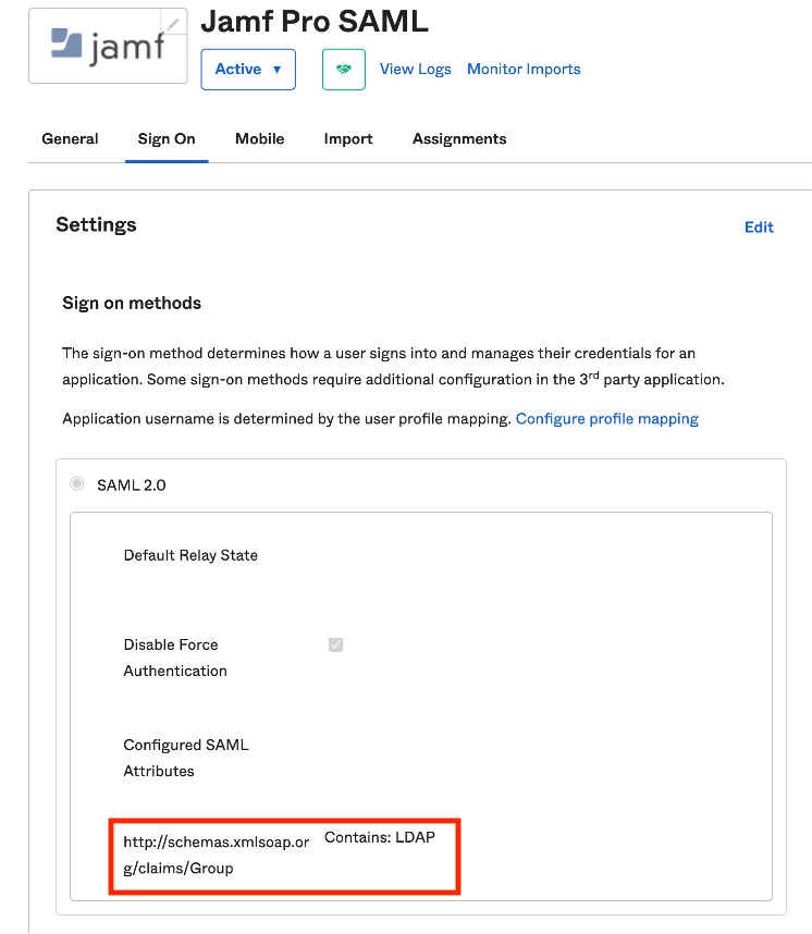

Maybe try a SAML tracer like "rcFederation Tracer" to validate what is happening. I had issues too which turned out to be that the response was trying to send all the group memberships but there was a max number. For me I had to get my Identity team to specify what groups to look for.
In this test example they added the group called LDAP.
