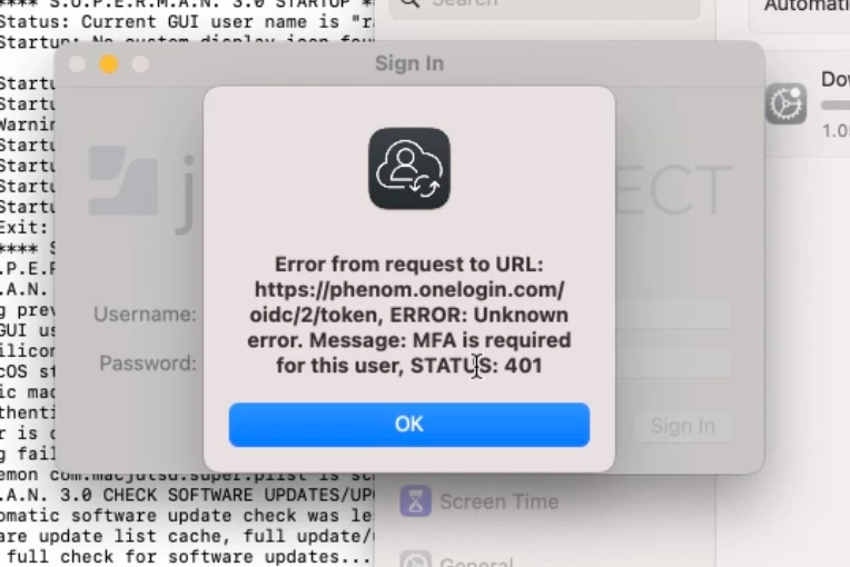

  • Oct 9, 2023 3:04 PM UTC
Hello Everyone,
When we signed into Jamf Connect menubar we're getting MFA error, does anyone have a idea about this error.
Attached the screenshot for reference.
