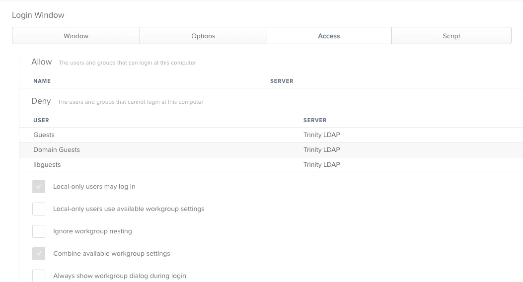

There actually is a deny list somewhere in JAMF from memory (maybe in the AD binding part), so first place to check is there, I believe it can contain both users and groups. You can also set deny in a configuration profile under Login Window.

Is there a configuration profile present? There is an option to deny users and usergroups under the LoginWindow payload:

Hello everyone. Thank you for your help. Though it is still not fixed. I appreciate your suggestions. Some of the macs are not in JAMF and still deny the one user. One mac we wiped out and immediately bound it to our domain with no extra software, and no JAMF. This one also deny's this one users login. We do not have a configuration profile that deny's anything or anyone. But it was good to check. We've compared the affected user's profile to another's profile and I was told that the affected users AD profile has more rights than the comparable users profile and it would not adversely affect the non-working users login privileges.
