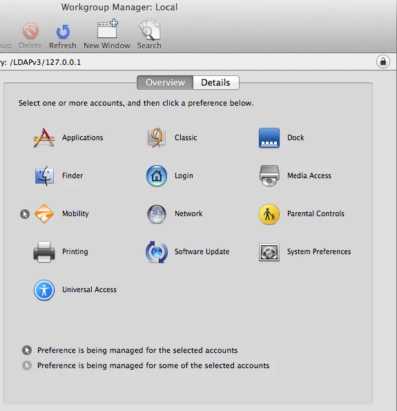

If you use Workgroup Manager, just select the Group, then click Preferences (the prefs icon in the top icon bar), and you will see all of the icons in the Overview pane. Click on "Mobility", and turn on the options you think you will need (you can see ours in the pictures below). Then save those settings and you are done.

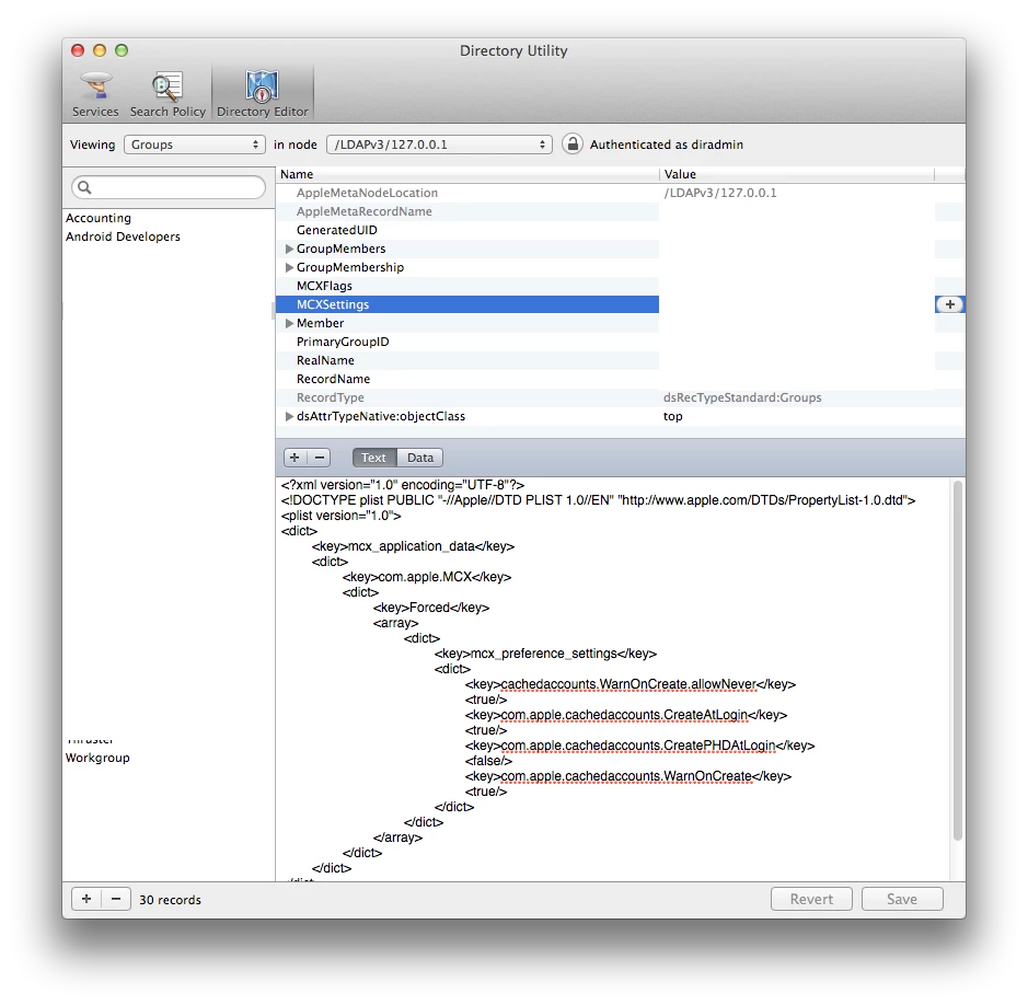

If you use Directory Utility, do the following.
  1. Open Directory Utility, select the node /LDAPv3/127.0.0.1
  2. Select Viewing of "Groups"
  3. Select your Group
  4. Click the Plus button to Add the Attribute (MCXFlags), and paste in the first xml info below.
<plist version="1.0">
<dict>
     <key>has_mcx_settings</key>
     <true/>
</dict>
</plist>
  1. Then add a 2nd attribute (MCXSettings) and paste in the xml below
<dict>
     <key>mcx_application_data</key>
     <dict>
          <key>com.apple.MCX</key>
          <dict>
               <key>Forced</key>
               <array>
                    <dict>
                         <key>mcx_preference_settings</key>
                         <dict>
                              <key>cachedaccounts.WarnOnCreate.allowNever</key>
                              <true/>
                              <key>com.apple.cachedaccounts.CreateAtLogin</key>
                              <true/>
                              <key>com.apple.cachedaccounts.CreatePHDAtLogin</key>
                              <false/>
                              <key>com.apple.cachedaccounts.WarnOnCreate</key>
                              <true/>
                         </dict>
                    </dict>
               </array>
          </dict>
     </dict>
</dict>
</plist>
6. Save it and restart OD.. Now Mobile Users are enabled for that OD Group.
<dict>
     <true/>
</dict>
</plist>
<dict>
     <dict>
          <dict>
               <key>Forced</key>
               <array>
                    <dict>
                         <dict>
                              <true/>
                              <true/>
                              <false/>
                              <true/>
                         </dict>
                    </dict>
               </array>
          </dict>
     </dict>
</dict>
</plist>
