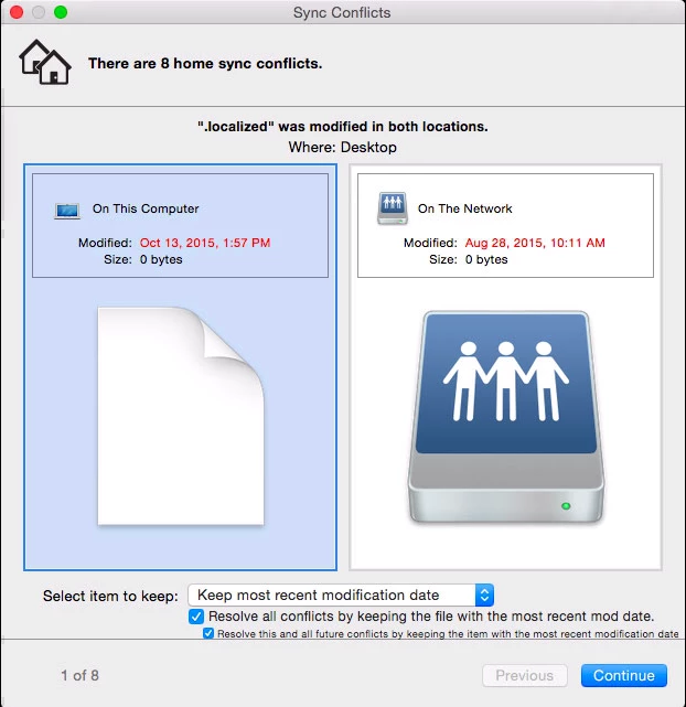

We are using Open Directory for our network users, and we are planning to change them to syncing mobile accounts rather than pure network accounts.
We would like this change to be as seamless to our users as possible, so we would like to see if there is a way to automatically set the settings for home sync conflicts. We would like to select the option to "Keep the most recent modification date" and also check the checkboxes that say to resolve all future conflicts this way as well.
Our goal is to set this setting without the user seeing this popup.
We are using a Casper configuration profile to set the Mobility settings that create the mobile account.
Thank you for any assistance you can provide.

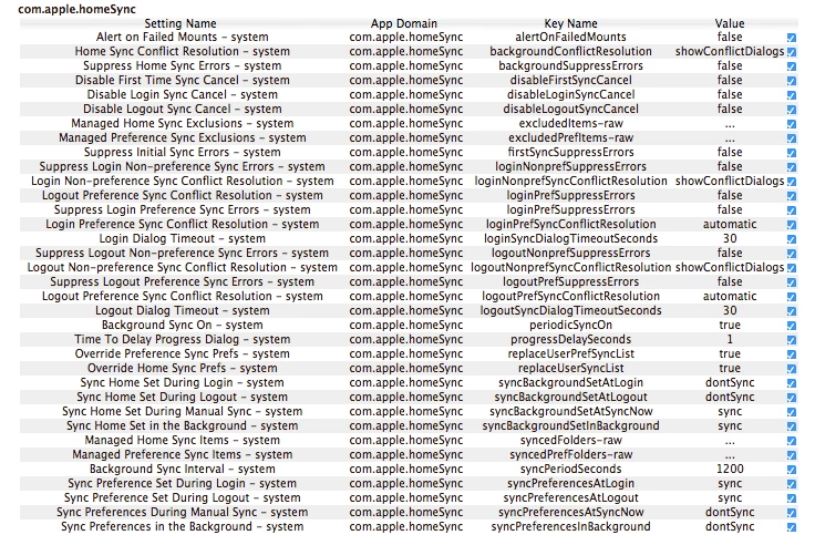

Best answer by davidacland
I haven't used it recently but you will need to track down what plist is storing the value of the bottom checkbox in your screenshot and look at creating a custom config profile to deploy the setting.
14 replies
davidacland
  • October 13, 2015

davidacland,
Thank you for your help. That should resolve my issue, although I'm not sure how to figure out which plist file it is using.

Managed Home Sync Items - system
<array>
    <dict>
        <key>path</key>
        <string>~</string>
    </dict>
</array>
Managed Preference Sync Items - system
    <array>
        <dict>
            <key>path</key>
            <string>~/Documents/Microsoft User Data</string>
        </dict>
        <dict>
            <key>contains</key>
            <string>~/Documents/Microsoft anv</string>
        </dict>
        <dict>
            <key>path</key>
            <string>~/Library</string>
        </dict>
    </array>
Some of this stuff is localized for Swedish, but I'm sure you can tell ;)
  • October 14, 2015
Hm, that wasn't pretty, but I bet you can use it anyways, just add a CR/LF after each closed tag.
  • October 14, 2015
Thanks again for all your help, bollman!
  • October 15, 2015
@bollman you can use the script tag (Looks like >_ in the toolbar) to preserve formatting
<array>
    <dict>
        <key>path</key>
        <string>~</string>
     </dict>
</array>
  • October 15, 2015
Thanks @calumhunter I should have known that :-/
