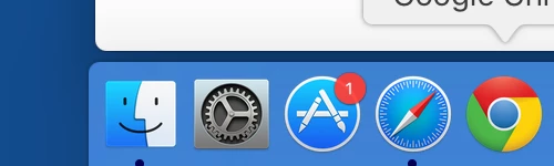

Which means Casper will see it as an uninstalled Update. Which makes me sad.
Is anyone else seeing this?
Expansion:
I already have OS X 10.11.1 installed. The App Store shows a download available in the Update section for OS X 10.11.1. But it is NOT the Combo Update that we all expect. It's actually the "Install OS X El Capitan.app", rev'd up to 10.11.1 (which they have always done) but now it's advertised in the Update section of the App Store.

But the App Store calls it an Update. Which means more and more of my users who I don't want to try and download it to install (only to be blocked by Restricted Software) will see and try repeatedly to download and install it. You know... because the little red number tells them to.

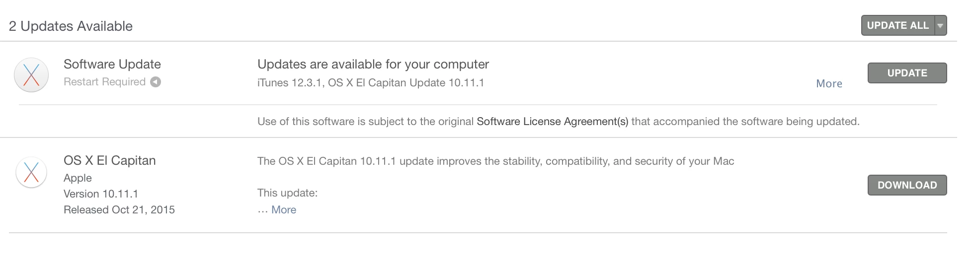

I see what you all are missing.
This is not the 10.11.1 UPDATE. This appears to be the stand alone "Install OS X El Capitan.app" that is usually found in the Applications section of the App Store... never in the Updates section before. They've just rev'd the version to 10.11.1.

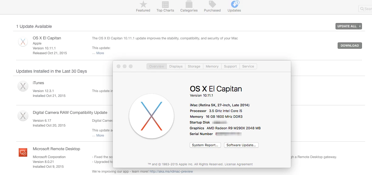

Check my pictures?
I AM running 10.11.1. I still see 10.11.1 as a Download, but in the Updates section of the App Store.
It also shows, in the App Store, there being 1 "Update" available, when there are none. It's just the download they're offering.
Thankfully Casper doesn't see that as a missing update.
But now ALL of my clients see this download in the Update section. I'm talking OS X 10.10, 10.9, 10.8, etc etc ALL see this El Cap "download" in the App Store under the Update section. This causes there to be a red 1 on the App Store icon, which means users will try to download & install it, which in my environment leads to a world of hurt.
Despite it being blocked by software restriction, do I really need to waste the bandwidth to have 3000 people try to download the 6GB "Install OS X El Capitan (version 10.11.1) that they can't install anyway?

It does make sense. I'm taking a wild guess, but that would occur if you have the OS X installer on your computer as it technically is an app like Apple Remote Desktop, Pages, Keynote, etc. The App Store is telling you that you have an update to the OS X installer app.

@bpavlov is correct. You are seeing the update for the Installer App. If it were the Software Update for 10.11.1, It would say "Software Update" of the left rather than "OS X El Capitan".
I haven't updated my laptop yet, and I still have the old installer so here's what I see.

The splash screen at the top advertising the new OS has been on the Upgrades section. A separate downloadable version of the .app installer in the portion where all other App & OS updates have always appeared... That's never been that way before this.
But holy (&@#$*(&#$@% @bpavlov ! I think you're right. It just so happens that every VM, Desktop, & Laptop I checked all have the El Cap installer on them. And that is advertised as an Update for them. Once I actually found a device that didn't have the "Install OS X El Capitan.app" downloaded... not advertised.
Well color me embarrassed. The sky ISN'T falling!
