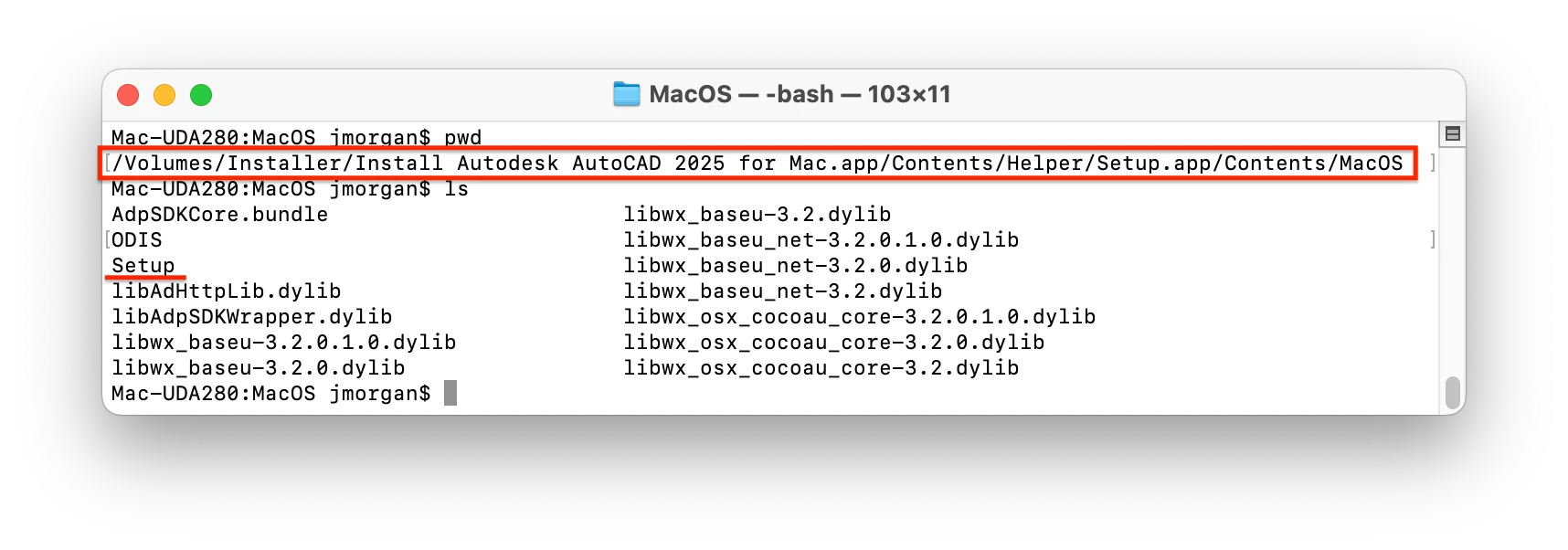

Thanks, I think I've got it, but I'm getting this error message when the script runs during policy. I get the same error message if I run "open" command via Terminal.
Jim

hi Jim, this maybe because the PKG is different, im using autocad 2023, you are using 2025, the setup path executable maybe different

Could it be because of the spaces you have in the command?
sudo /Volumes/Installer/Install\\ Autodesk\\ AutoCAD\\ 2025\\ for\\ Mac.app/Contents/Helper/Setup.app/Contents/MacOS/Setup --silent
The above has backslash to account for spaces.

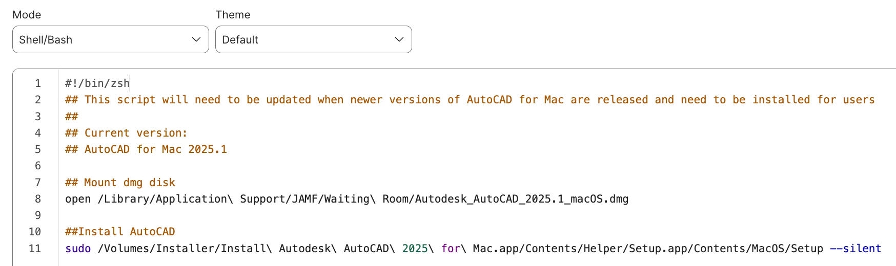

It looks like the error message strips out backslashes. I think that I'd accounted properly for spaces in the path. Here's the actual script. I used zsh, since that is what was in JDK-JAMF's example. Mode would still use Shell/Bash, correct?
Yes, newer install so I had checked to make sure that setup was in same path before creating the script.

I placed the .dmg in Downloads and ran "open" command, followed by "sudo" command, and application gets installed. It seems like there is something going on in when the .dmg is in the Waiting Room. I note that the perms for Waiting Room are for root only, but that shouldn't matter to Jamf Pro would it?

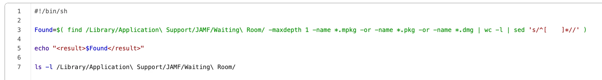

Found this from a good while back, which sounds like what is happening to me.
https://community.jamf.com/t5/jamf-pro/waiting-room-folder-permissions/m-p/168315#M157230

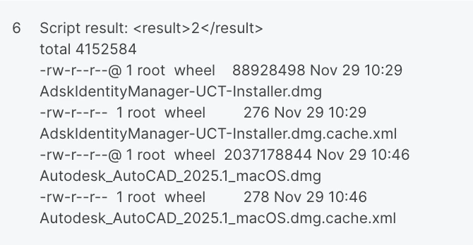

I set up this script to check if there is actually anything in Waiting Room and to report contents.
Looking at logs after running the script, we know that the ACAD 2025 .dmg is in there, just fails to run it. Curious that the .dmg does not have execution perms for anyone -- not even root?
